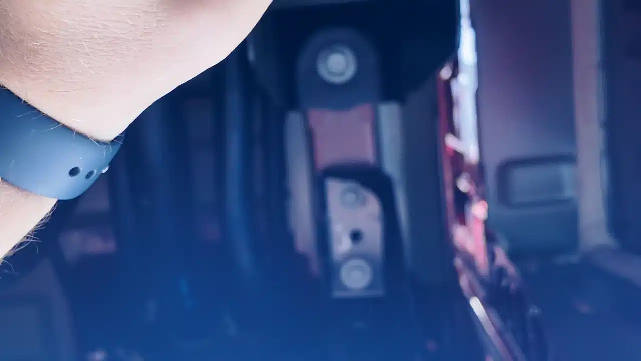

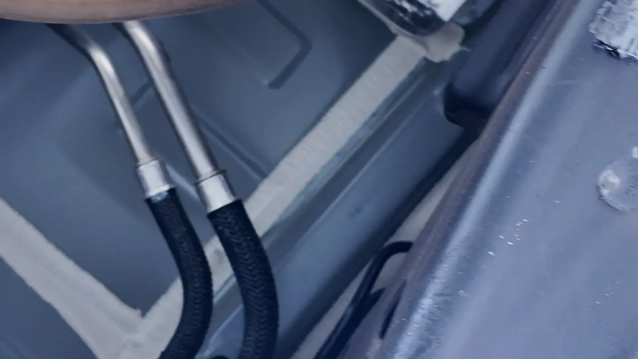

What I saw under the light-duty truck
The camera shows the light-duty truck’s coated frame and nearby underbody hardware.
The camera shows the light-duty truck’s coated frame and nearby underbody hardware. (Video still: Tim Esterdahl)
I started by looking along the frame of the light-duty truck. The coating was visible as I moved the camera underneath, and I described it in the video as the same kind of wax finish I had seen before. I also moved the camera farther under the truck to show the surrounding hardware, including the exhaust, rear axle, shocks and suspension.
That gives you a closer view than an exterior walk-around can provide. The new bodywork and interior may draw the crowd, but I know some of you want to see what is underneath before you get excited about ordering a truck.

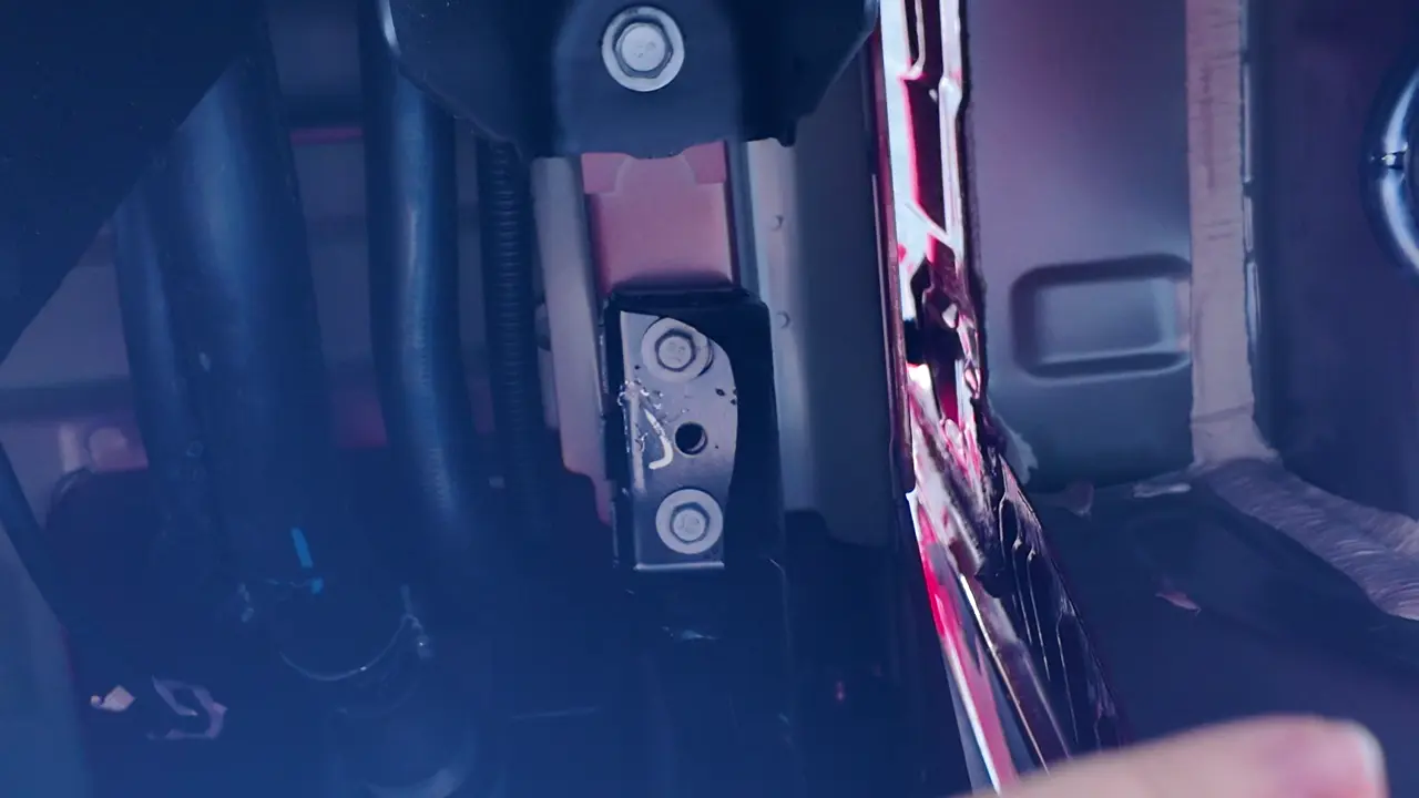

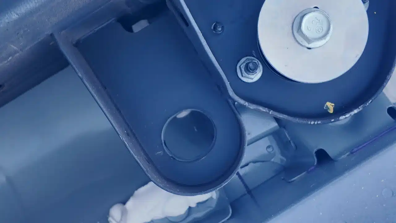

The heavy-duty truck had a similar feel
Checking the heavy-duty display truck’s frame coating by hand.
Checking the heavy-duty display truck’s frame coating by hand. (Video still: Tim Esterdahl)
On the heavy-duty truck, I touched the frame coating and could lift material with my fingers. I checked my fingertip on camera and identified the material as wax. That was the useful part of getting underneath these trucks in person: I could show you what I was seeing and what it felt like, rather than guessing from a polished display photo.
These new GM full-size trucks have wax-coated frames. I found wax on the light-duty and heavy-duty trucks at the Texas State Fair, and GM confirmed the continued use of wax when I followed up. That settles the question of whether these new full-size trucks have abandoned wax: they have not. My inspection and GM’s confirmation of wax do not, by themselves, describe every treatment that may be present beneath it.
Why GM’s wax coating remains controversial
Wax coating on the heavy-duty display truck during my inspection.
Wax coating on the heavy-duty display truck during my inspection. (Video still: Tim Esterdahl)
The debate is about whether that protective layer stays in place. Owners have reported wax separating from the frame, with corrosion showing where the coating is missing. GM has documented that condition in service bulletin 19-NA-255. The January 2024 revision includes Silverado and Sierra 1500 models as well as 2500HD and 3500HD trucks. It identifies inadequate surface preparation by the frame supplier as a possible cause and provides a procedure for repairing affected areas.
That is evidence of a recognized problem on some trucks, not proof that every wax-coated frame will fail. The bulletin also is not a recall or a durability verdict on the new trucks I inspected today. But it explains why owners want more than a clean-looking frame at an auto show.

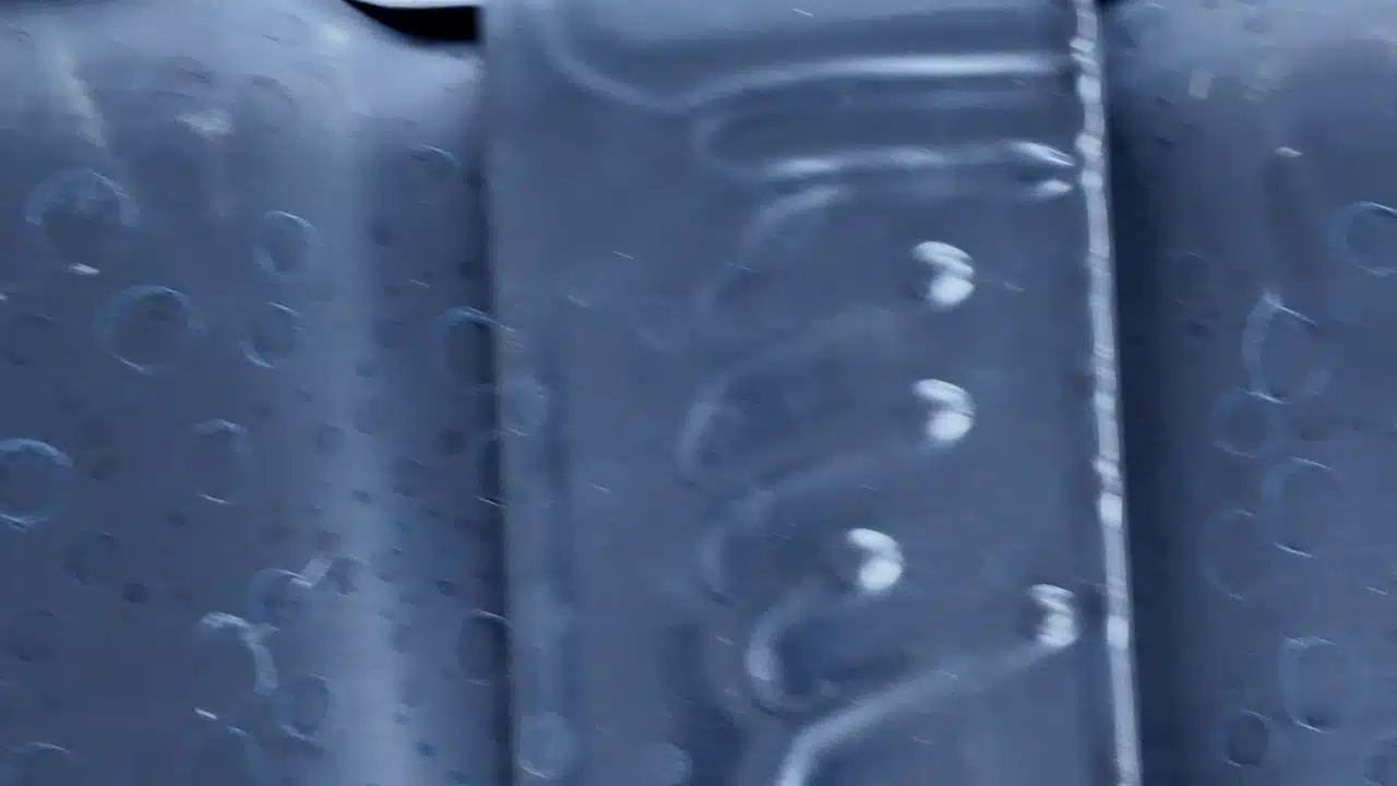

GM’s midsize trucks take a different approach
The full-size display truck’s underbody, which uses a different frame finish from GM’s midsize pickups.
The full-size display truck’s underbody, which uses a different frame finish from GM’s midsize pickups. (Video still: Tim Esterdahl)
GM’s HD trucks have used wax-coated frames for years, alongside the full-size light-duty pickups. Finding wax on the HD truck today is a continuation of that practice, not a newly introduced change. The Colorado and Canyon are the midsize exceptions, with the e-coated, painted finish discussed in our earlier reporting. In my April 2023 report on the Colorado’s painted frame, Chevrolet confirmed paint rather than wax, and GMC confirmed the same for Canyon.
