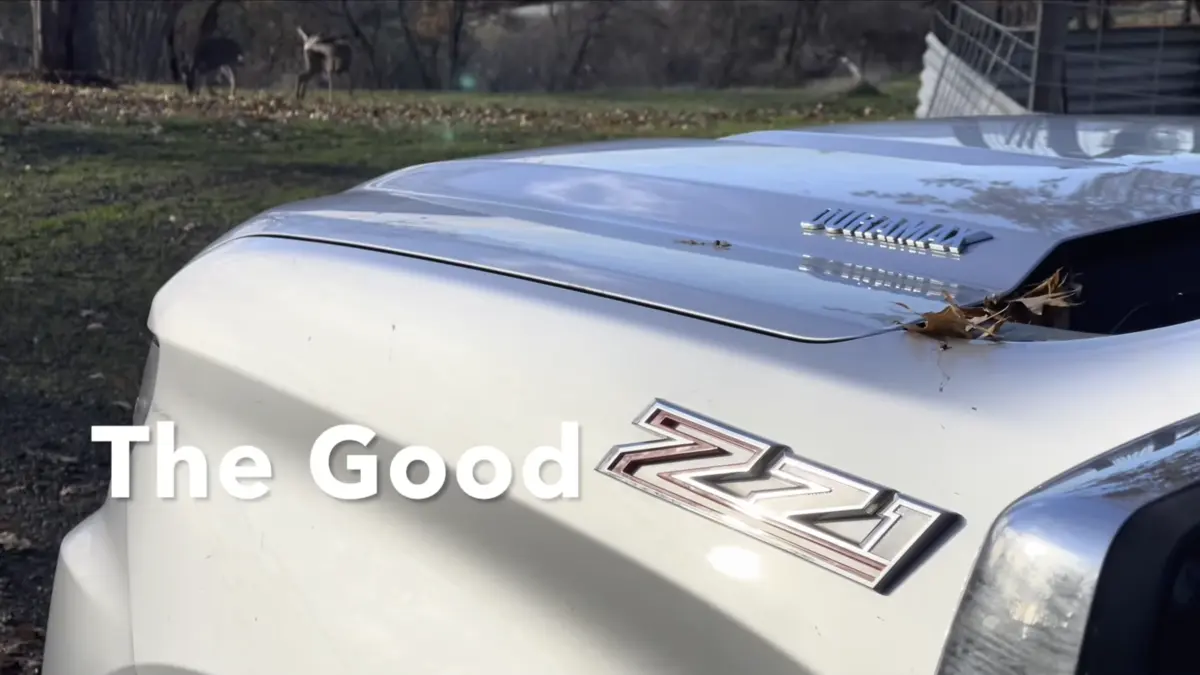

Z71 badge on the hood of a 2020 Chevrolet Silverado 1500
The Silverado’s Z71 package gave the owner enough off-road capability for hunting and moderate trail use. (Image: The Oregon Tale/YouTube)
Fuel economy leads the owner’s list of positives. He says the full-size, four-wheel-drive truck generally returns 26 to 28 mpg. His best result was 33 mpg on a trip of more than 400 miles. His driving includes plenty of highway travel, some city use and substantial idling during roadside meetings, so the number is a real-world average rather than a single carefully managed economy run.
He also calls the Z71-equipped truck capable enough for hunting and moderate off-road use. The Silverado’s length limits its approach and departure angles compared with a shorter dedicated off-roader, but it has handled the woods and trails he asks it to travel.
The quieter diesel character is another standout. He says people have occasionally warned him that he was parked at a diesel pump because they assumed the nearly silent truck was gasoline-powered. At 6 feet, 3 inches tall, he also finds the Silverado comfortable for long drives.
Most important, he says the engine is stock. There are no performance modifications or emissions-system changes muddying the ownership record. This is one owner’s experience with a factory truck that accumulated miles through ordinary work and travel.

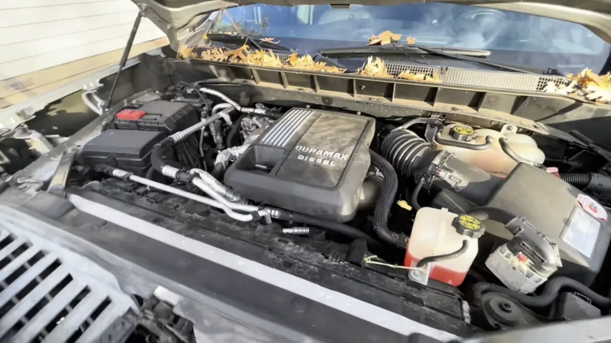

3.0-liter Duramax diesel engine in a 2020 Chevrolet Silverado 1500
The owner’s Silverado needed a radiator around 50,000 miles and a water pump shortly before 100,000 miles. (Image: The Oregon Tale/YouTube)
The cost story changes at about 50,000 miles. The owner says he had noticed a faint coolant smell for some time before a dealer pressure-tested the cooling system and found a leaking radiator. Because the radiator was not covered as a powertrain component, he paid for the replacement himself. He does not state the repair bill in the video, but calls it his only notable out-of-pocket repair beyond oil, transmission, differential and other fluid services.
A second coolant leak appeared shortly before 100,000 miles. This time the water pump was beginning to weep. The repair was completed under the truck’s powertrain warranty. He says the dealer also replaced what he believes was the EGR cooler during the same visit, again under warranty.
He also recalls replacing three or four glow plugs after fault codes appeared. Those repairs were covered as engine components. The warranty coverage matters to his verdict: The truck experienced several component failures, but most did not become direct repair bills.

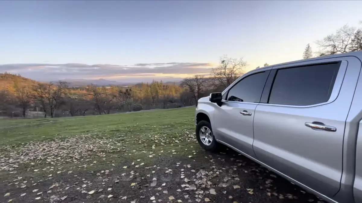

Silver 2020 Chevrolet Silverado 1500 parked beside a wooded hillside
The owner says his four-wheel-drive Silverado generally returns 26 to 28 mpg and has reached 33 mpg on a long trip. (Image: The Oregon Tale/YouTube)
