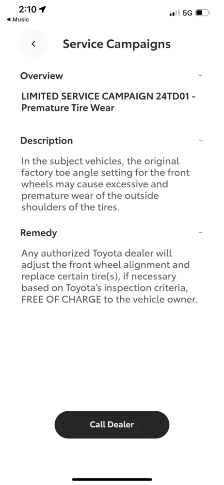

Apparently Toyota and Falken have discussed the issue, and Toyota is planning on replacing all the tires for free according to a customer service campaign notification Sparks sent us.

Service campaign alert. (Photo courtesy Jason Sparks)

LIMITED SERVICE CAMPAIGN FOR MY22-23 TOYOTA TUNDRA HV – TRD PRO ONLY – PREMATURE TIRE WEAR
US: 24TD01
CANADA:
UNKNOWN
PRODUCTION DATES: EARLY APRIL 2022 TO LATE MAY 2023
EXPIRES: MARCH 20, 2025 AND ONLY AVAILABLE AT AUTHORIZED TOYOTA DEALERS
APPROXIMATELY 8,800 VEHICLES ARE COVERED, WITH APPROXIMATELY 400 BEING IN PUERTO RICO.
Toyota’s Mike Kroll, vice president of Product and Mobility Communications at Toyota Motor North America, confirmed the Limited Service Campaign details are accurate.
