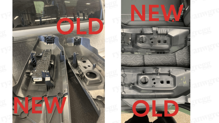

Driver’s side seat trim
  • Updated seat trim (reinforced)
  • Some have even broken the updated trim
  • 4,000+ backordered at one point in time
2024 Toyota Tundra known problems 3
Photo comparison of new versus old seat trim piece. (Photo Courtesy Ryan Gregg)
