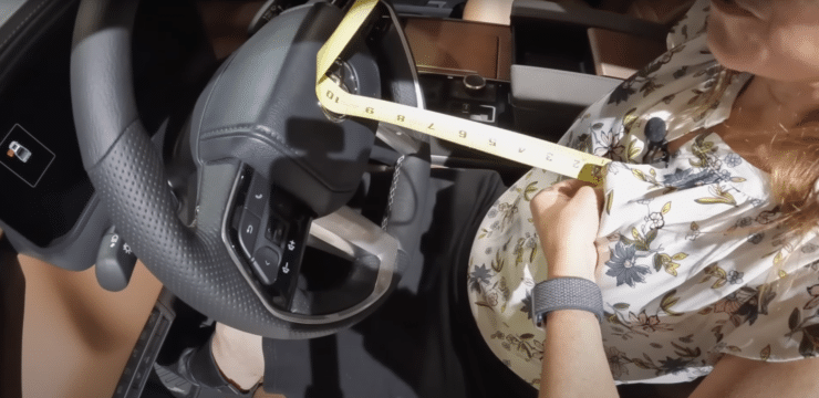

jills driving position measuring tape
What if I’m too close to the wheel?
If you adjust your seat so that your arm is straight when your wrist is just draped over the wheel, that should be at least 10 inches – even if you’re a shorty like me. However, if you’re not sure, it’s always a good idea to pull out the tape measure.
