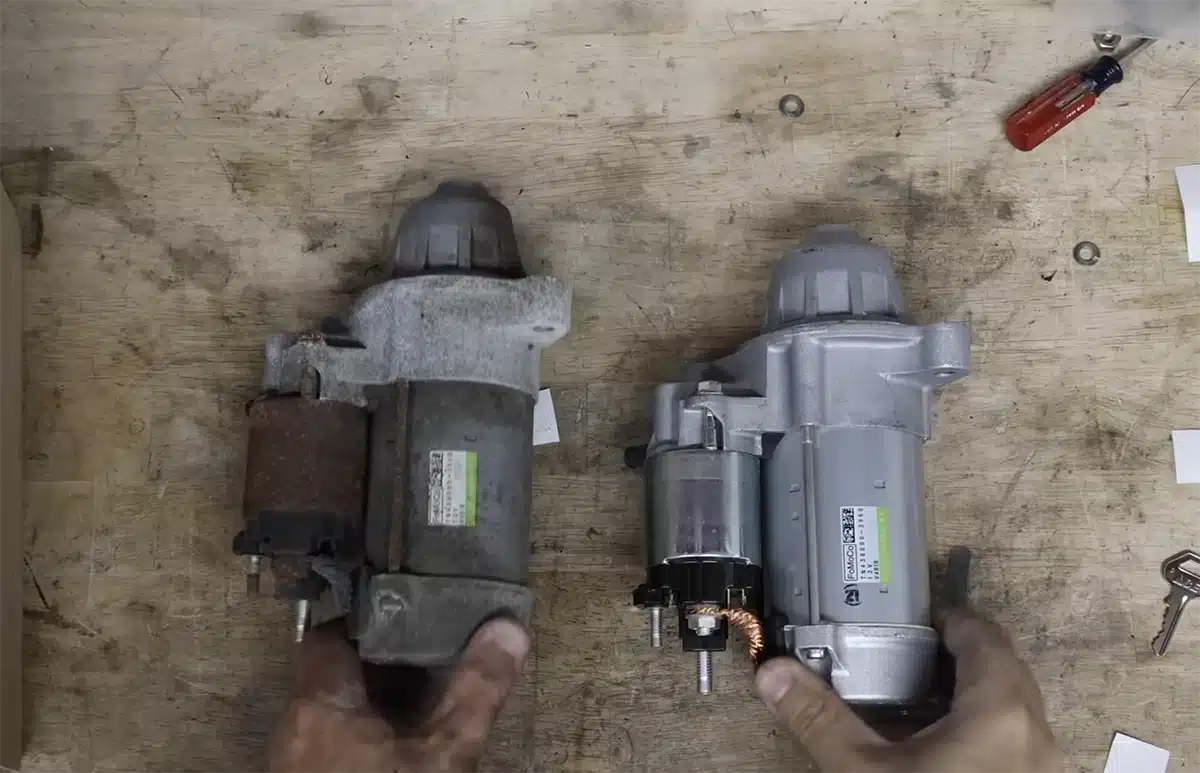

The owner disabled the F-150’s automatic start/stop system around the 30,000-mile mark because he did not want the starter repeatedly cycling in traffic. Despite that precaution, the starter eventually deteriorated and required replacement.
He had thought the battery was failing and replaced that first. Then, looking at the starter, he realized how corroded it was, and that was the real issue.
The starter was one of the most substantial actual repairs recorded during the first 100,000 miles.

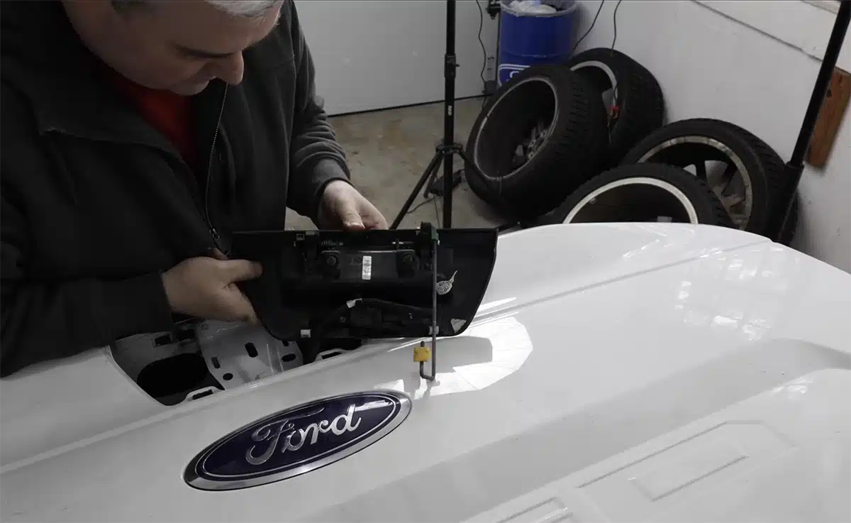

The tailgate handle suffered from corrosion, which is not especially surprising on a truck driven through New England winters. While the problem did not affect the engine or transmission, it is another example of the smaller issues that appear as a truck ages.

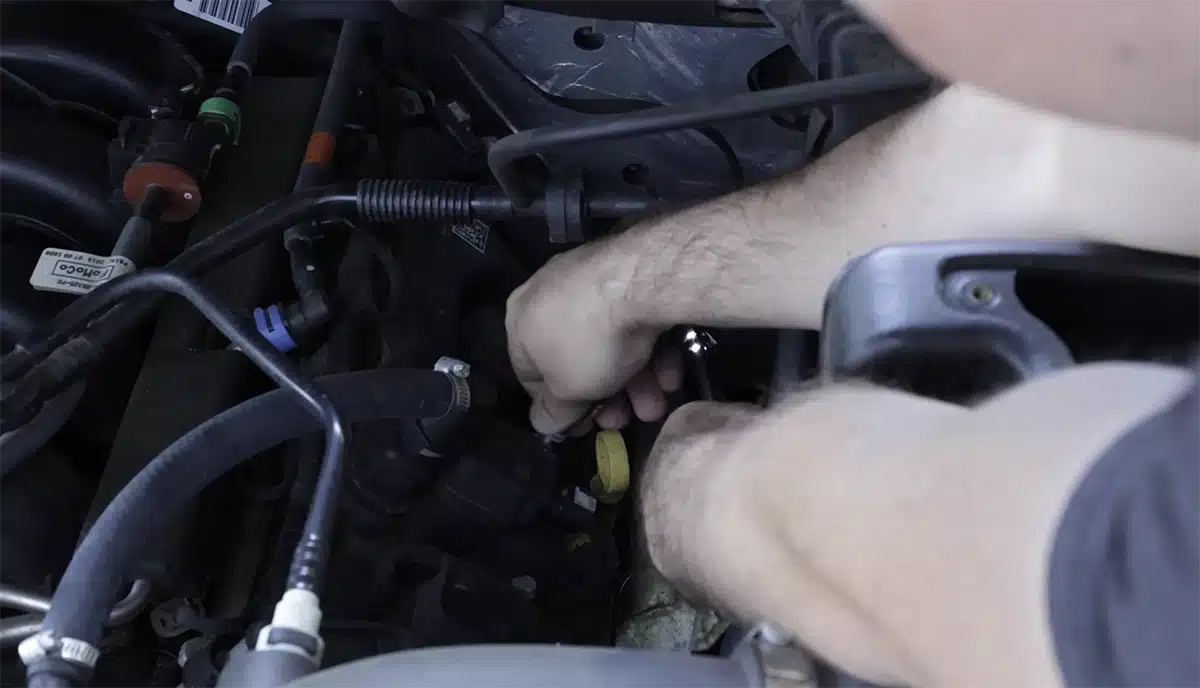

Over seven years and 100,000 miles, the owner spent $3,438 on maintenance compared with $826 replacing parts that broke.
Oil changes accounted for $1,600 of the maintenance total. A flat-tire incident cost another $1,000, while spark plugs were $65, coolant was $23 and a spare-tire lock cost $10. He also cleaned the truck’s door drains himself at no cost.

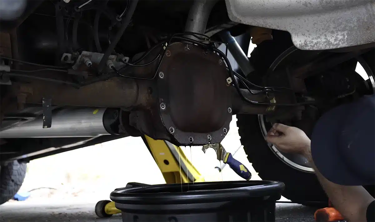

Would He Buy Another Ford F-150?
2018 Ford F-150 5.0L V8 problems
He is also doing regular maintenance like draining the rear differential (Screenshot by Tim Esterdahl)
