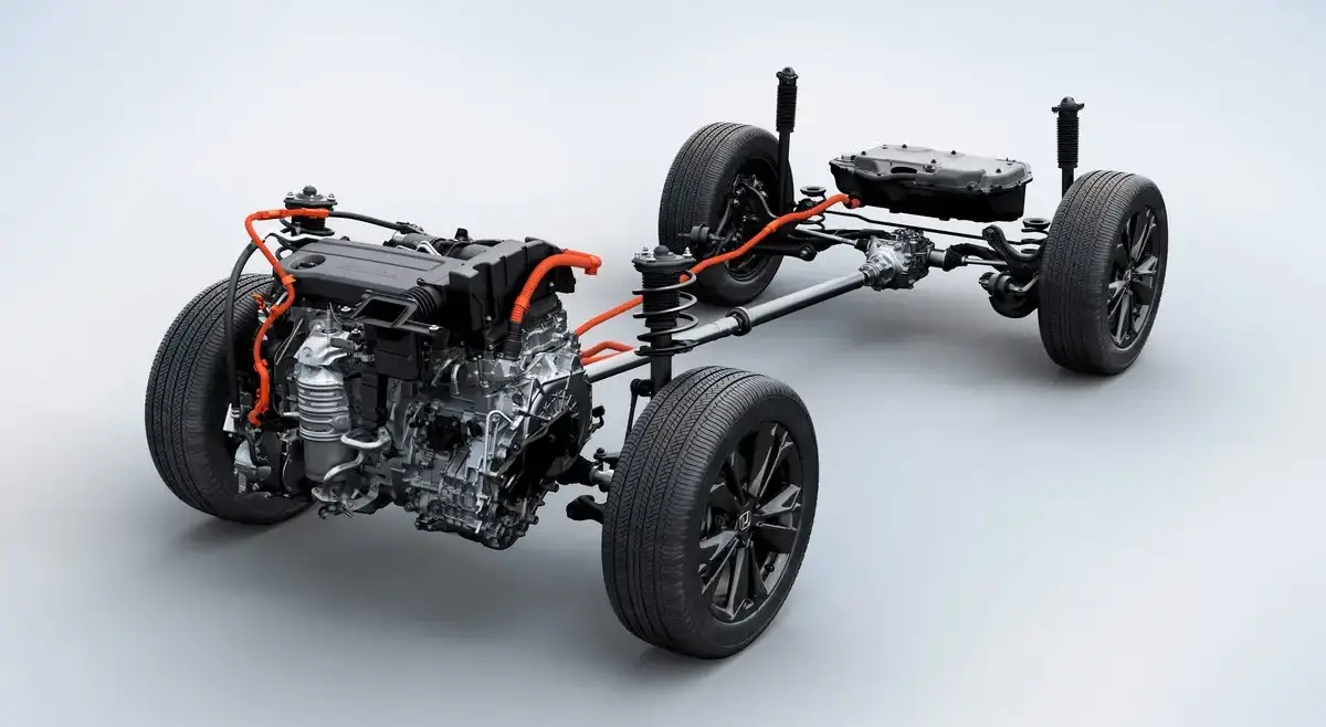

Sorry, current and potential Honda CR-V Hybrid owners, but those models face two more potential problems. First up, 2023 models can develop an internal wiring breakage. The problem isn’t an actual wire, but a copper coated aluminum bus bar that can break under certain circumstances. If the copper coating on the bus bar is too thin and allows the underlying aluminum to be exposed, a chemical reaction inside the battery can weaken the bus bar and allow it to break. Loose electrical connectors inside a battery are never good and could cause sparking or even a fire. Under NHTSA recall 24V-745 hybrid CR-Vs will have the battery module replaced with an improved version.
Mixing electricity and conductive fluids rarely produced a positive outcome. For 2025 Honda CR-V Fuel Cell EVs there is an issue where fuel cell coolant can leak into the fuel cell case and cause a short circuit. There was an issue with the fuel cell assembly involving sealant and gaskets that keep fuel cell coolant from escaping to where the electrical connections live. Electricity plus coolant means a short circuit and a bad day. Luckily NHTSA recall 25V-858 simply replaces the troublesome fuel cell stack assembly with a new unit featuring improved sealing and better machining.

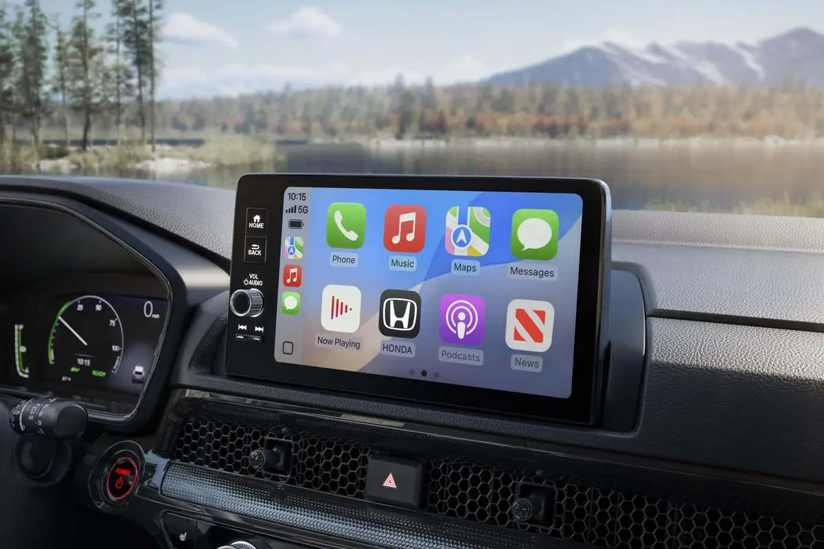

While not a recall, some 2023-2026 Honda CR-V owners have reported issues with the dash infotainment screen simply going dark. Doing the old “turn it off and back on again” doesn’t seem to work. The jury is out on the actual cause, but the screen sometimes comes back to life on its own. Some have reported success in resetting the infotainment system, but taking it to the dealer is probably the best line of action.
