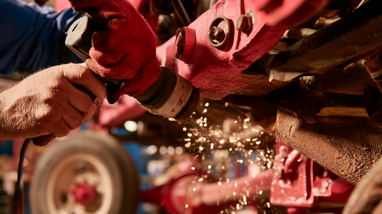

  3. Remove loose paint and rust. Use a wire brush, 60-grit sandpaper, or a dual-action sander or grinder with a flapper wheel. Feather the paint edges so the repair blends instead of leaving a ridge.
  4. Sand to clean, bright metal. Take it down to sound steel wherever you can reach. Any active rust left behind will keep spreading under your new finish, and even small dents left in the panel will telegraph through the paint.
