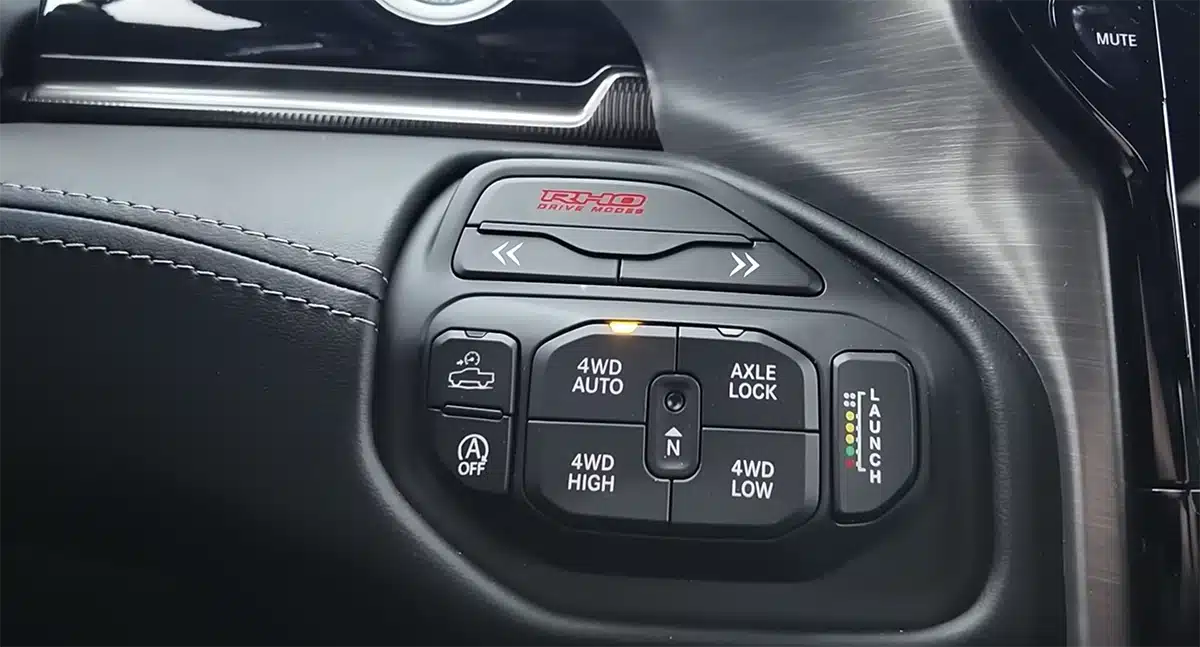

4WD Auto Works 1
The 4WD cluster in the Ram RHO (Photo by Tim Esterdahl)
If you’ve ever wondered how 4WD Auto works, you’re not alone. Modern trucks from Ram, Chevrolet, GMC and Ford all offer some version of an automatic four-wheel-drive system, but many owners still aren’t sure when it engages, whether it’s always sending power to the front wheels or how it differs from 4WD High.
Instead of relying on internet forums and conflicting opinions, I asked Ram Chief Vehicle Synthesis Manager Doug Killian to explain exactly how the system works in a video interview. Although we discussed the Ram 1500 RHO, the engineering concepts behind modern 4WD Auto systems are remarkably similar across today’s full-size pickups.
4WD Auto Is Always Ready, But It Isn’t Locked Like 4WD High
