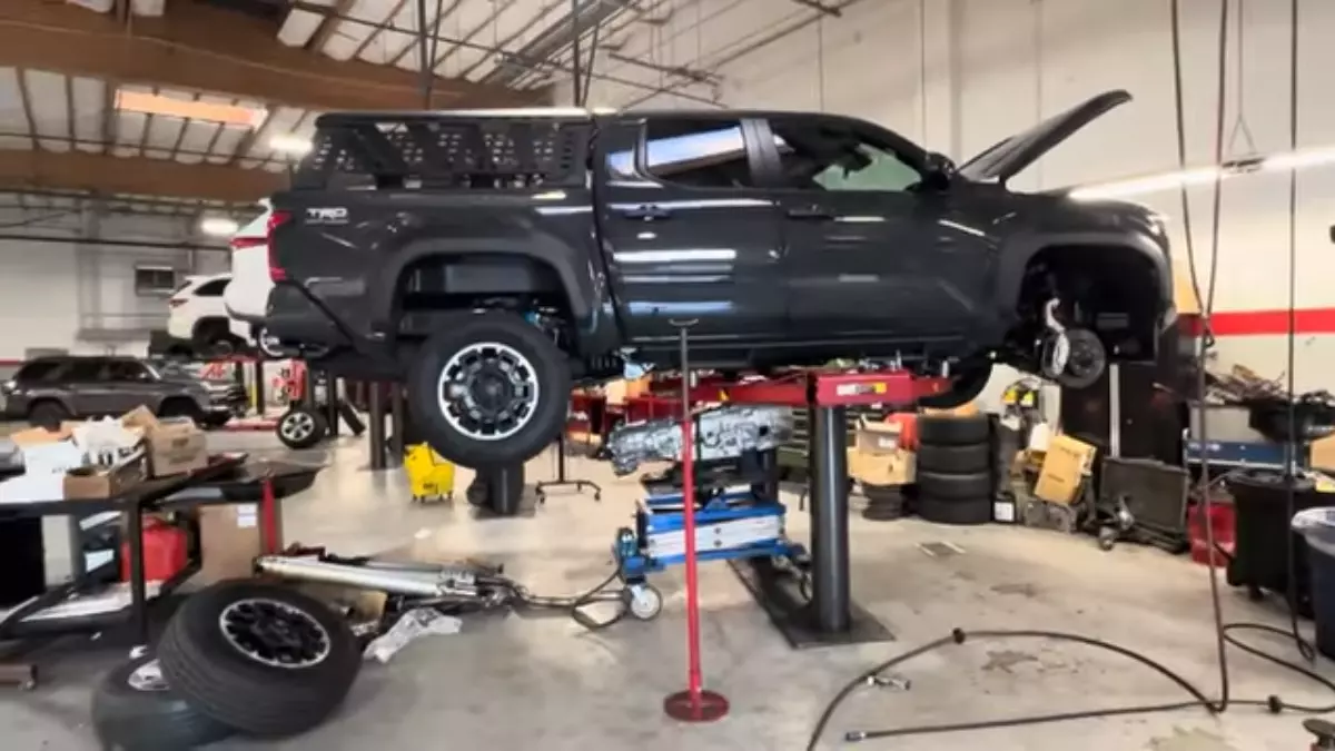

Toyota’s fourth-generation Tacoma has generally enjoyed a smoother launch than many all-new trucks. Most early production issues affecting 2024 models have already been addressed. But one recent teardown of a Tacoma equipped with the hybrid i-Force Max powertrain has revealed a manufacturing defect severe enough to destroy an engine with just 200 miles on the odometer.

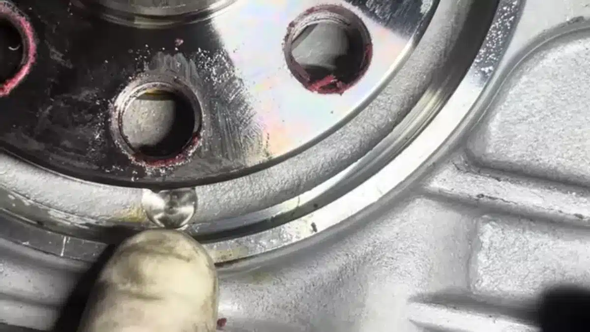

Oil transfer hole behind the rear seal not completely drilled through. (Screen capture from WaltNasty on YouTube)
The issue appears, on teardown, to mainly have been a quality assurance miss at the factory. The question of whether this is an isolated miss or a broader quality control problem is still unanswered.
On most engines, the rear seal on an engine’s crankshaft will have one or more holes ahead of it that allow oil to enter into the space between the seal and the inner housing to lubricate the back side of the crankshaft where it emerges from the block to connect to the transmission. This main seal is designed to allow the oil to circulate around the shaft and re-enter the engine block to drain into the upper oil pan.
On the Tacoma i-Force Max, the oil’s movement is facilitated by one relatively large hole drilled through the block behind the seal. In the case of this Tacoma teardown, however, the hole was not drilled all the way through, leaving only a tiny pinhole to allow the oil’s movement. This resulted in a one-way transfer of oil into the seal with no return, causing pressure to build that resulted in the seal unseating and failing. That, in turn, created a catastrophic oil leak and engine failure.
The truck had only 200 miles on it, according to the YouTube mechanic working on it.
Replacing the Engine Is the Result.. But They Are Backordered

The warranty on the truck replaces the engine, but the truck’s owner could be waiting weeks or months for that to happen. Because the new i-Force Max turbo-fours are on backorder with Toyota. Hybrid components are hard to come by right now and Toyota is experiencing bottlenecks, slowing production.
