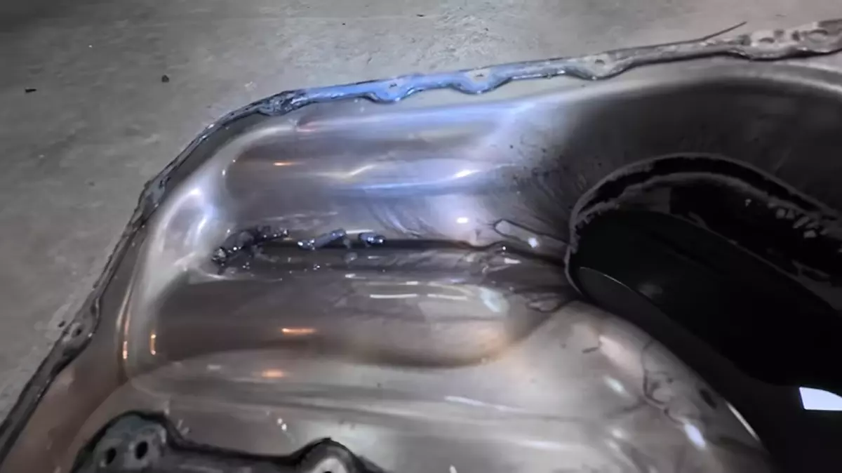

Typically, when thrust bearings fail, most of what’s left of those bearings are found in the engine oil pan as they are chewed up by engine forces and spit out into the lowest part of the engine. In this teardown engine, however, everything was still running despite low oil pressure and significant crankshaft end play. Giving a better glimpse at the process before total catastrophe ate too much of the evidence.

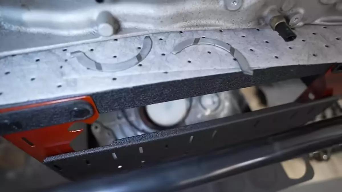

Interestingly, the engine oil pan contained only one thrust bearing piece, which was unusual since the engine should have two thrust bearings controlling the crankshaft’s forward and backward movement.

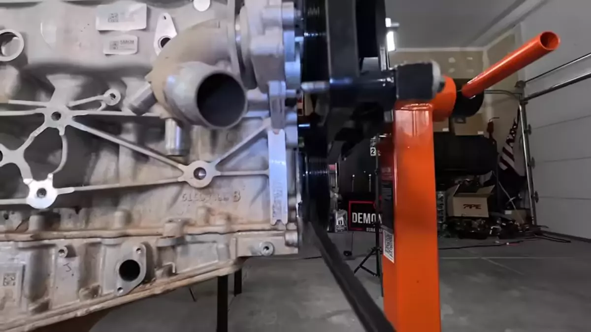

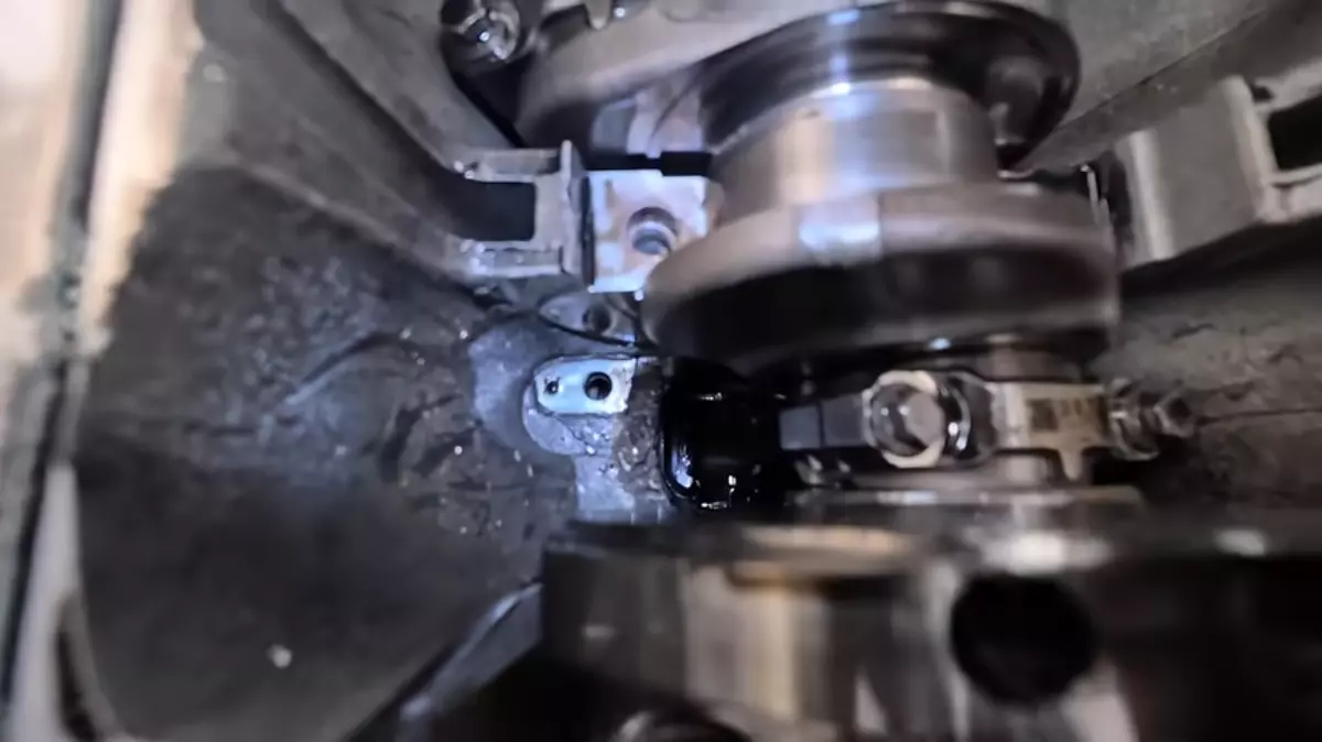

Before taking apart the engine, DemonWorks on YouTube, put a pry bar onto the crankshaft ends to test play and found that there was a significant amount of it. Normally, there shouldn’t be any. After that, draining the engine oil and removing the pan to inspect for engine pieces or metal shavings found the first evidence. Inside were pieces of a thrust bearing and other debris indicating something with screw threads had also become a victim as the engine began to die.

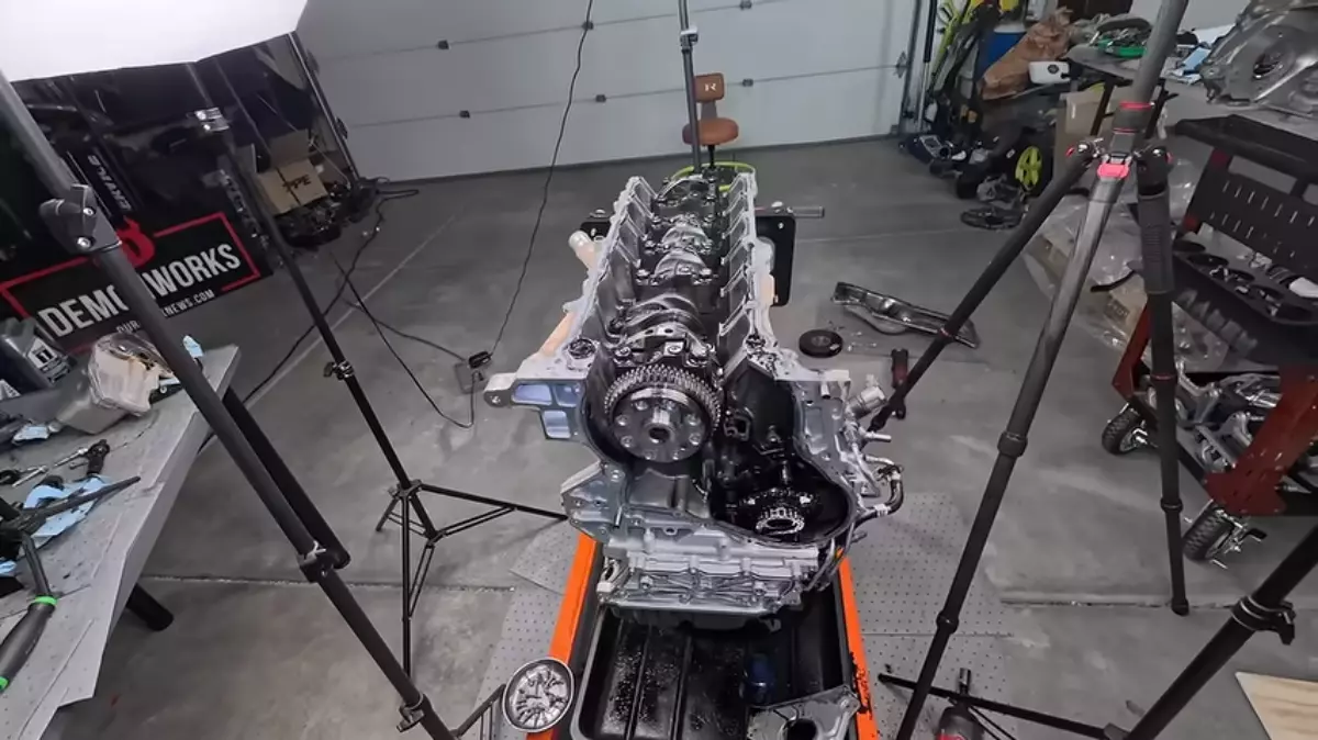

Once the heads came off, the problem in the engine became immediately clear. One of the oil squirters, the tiny pipes that send engine oil up behind the piston heads to lubricate and cool, was missing entirely. It appeared to have been removed so cleanly that it may not have been inserted and torqued into place correctly to start with. That explained the low oil pressure.
The oil squirters are designed to not only send oil to the underside of the piston head, but to do so with pressure. They do this by having a larger opening for the oil to arrive at the squirter and a smaller opening for its exit, creating a higher-pressure stream. Similar to a thumb on the end of a garden hose. When the squirter is gone, the oil comes out at a faster, unimpeded rate, lowering pressure.
The inspection of the engine block led to another question: nowhere in the block were the remains of another thrust bearing found. There should be two, but the chunks found in the oil pan only accounted for one. Where did the other one go? Or was it never there?
The absence of a second thrust bearing led the teardown mechanic to theorize that the engine may have left the factory with only one bearing installed. While the teardown cannot conclusively prove that scenario, the lack of identifiable bearing material elsewhere in the engine raises questions about whether an assembly error occurred during production.

  • Missing Thrust Bearing: The engine appeared to be missing one of the two thrust bearings from the factory. Only one complete thrust bearing was found, with fragments of another.

  • Oil Squirter Failure: An oil squirter in one of the cylinders was removed fairly cleanly by engine forces, indicating it was not properly torqued into place.
  • Oil Pressure Loss: The excessive movement and damage/removal of the piston oil squirter contributed to low oil pressure, triggering the engine codes that stopped the engine before it cratered on itself.

Checking the crankshaft for excessive end play, as shown in this screen capture, may find the problem before it’s too late (Image via DemonWorks/YouTube)

For owners and mechanics, this means that checking crankshaft end play early can help identify potential issues early on. It’s also important to understand that the oil pump belt is likely not the cause of thrust bearing failures, despite often being accused of such. And it shows that GM should recognize the importance of proper assembly and quality control in engine manufacturing.
