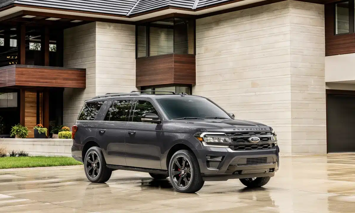

2022 ford expedition stealth edition performance package 18
2022 Ford Expedition Stealth (Photo courtesy of Ford)
