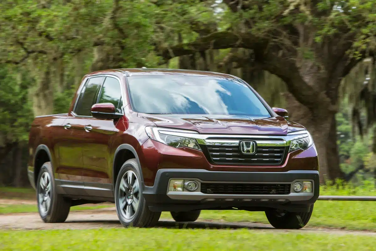

Honda Ridgeline engine failures
More Honda Ridgeline engine failures are among other failures that have lead to another Federal probe into what is going on with the 3.5-liter V6 engine. (Photo courtesy Honda)
