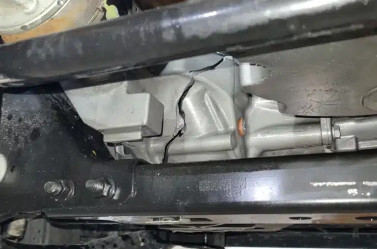

Differential housings breaking
Finally, many owners are reporting their differential housings have broken for seemingly no reason. Some have speculated it is a bad cast from the factory.
This photo shows a massive crack in the differential cover.
2021-2024 Ford F-150 known problems
This is a pretty large crack in the differential housing. (Photo courtesy hotrodmex)
While it seems like a repair-it-and-you-are-done fix, forum user Discipher is on his 4th differential cover in just 26 months.
“My truck is a 2021 F150 – XLT 2.7 4×4 with locking rear with 54,000 km (~34k miles) purchased Nov 21. First differential was replaced about 8 months after purchase and was a complete drop in differential replacement. About 6 months later that one failed and they replaced what I believe was the internal components of the diff but didn’t quite give me an explanation of what. Now I am heading into yet another likely replacement. Goes on Tuesday for a full inspection and determination of cause. Same issues as before. I’m assuming something in the transfer case is causing the issue as this time I had some major clanks right after putting it in four low with the electronic diff lock engaged so I could to pull my trailer up a hill where at the top I had to make a 90 deg turn while the trailer would still be on the incline.”
People have discussed the 90 degree turn as a possible reason for the differential cover breaking since you shouldn’t turn when the axles are locked. This is one possible reason for the issue, but I’d think this cover would crack after extended years of abuse — not just in 26 months.

    as far as the differential cover breaking, I’d like to know what kind of surface he is driving on when doing his 90 degree turn. Macadam I can see the issue happening. But if on macadam there is no reason he should need 4 low because he should have plenty of traction. On grass, he might need 4 low if grass is wet. But on grass the wheels should just be able to tear the grass up rather than the differential cover breaking when turning 90 degrees. Gravel the same thing, this should not be a issue. The service manager at the dealer should go look at his property and investigate what he is doing wrong.
