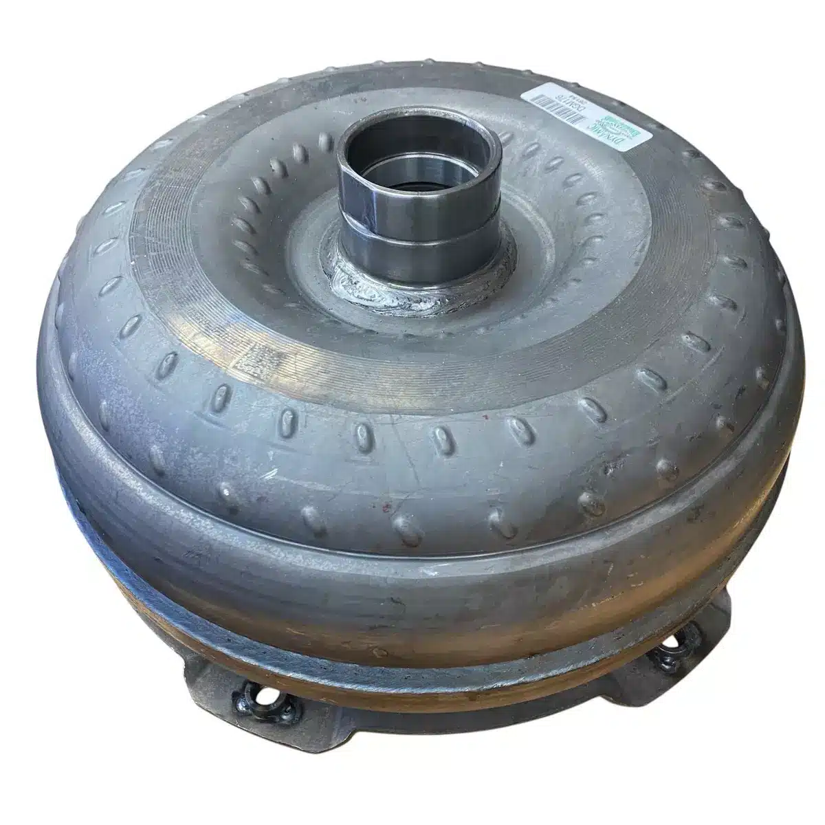

GM 8-speed automatic transmission torque converter (Photo courtesy GM Parts)

The truck must then be tested in Manual 7th gear. The dealer’s technician will drive the truck up to 7th gear and force it to stay there via manual shifting. If the shudder remains under those conditions, the dealer moves to the next step.
This step is not to replace the converter. Instead, it’s contacting GM’s Product Quality Center to get permission to replace the torque converter. In other words, a technician can’t simply diagnose a bad converter, order the part and get on with it. GM wants another set of eyes on the problem (well, the problem’s paperwork anyway) first.
