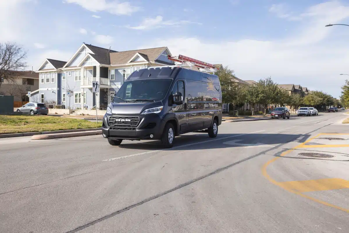

A 2025 Ram ProMaster work van on a residential street.
2025 Ram ProMaster (Photo courtesy of Stellantis)
