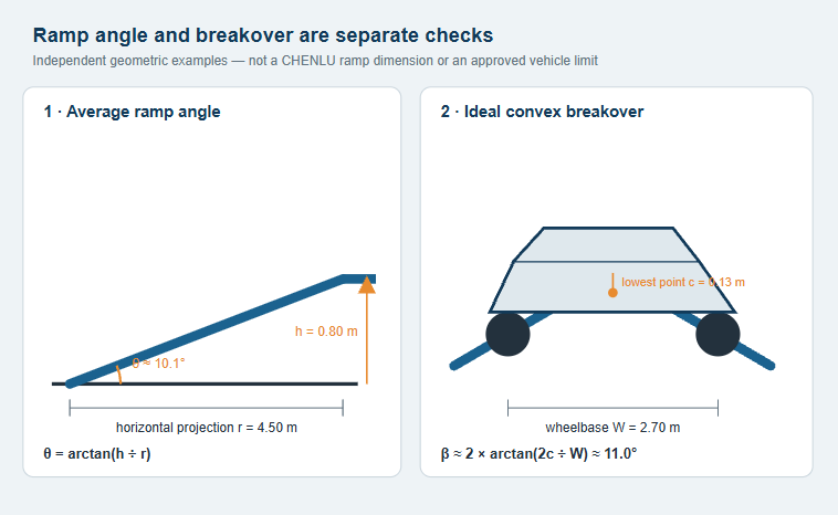

How Do Platform Height, Ramp Projection and Site Conditions Set the Ramp Angle?
Let h be the vertical rise and r the ramp’s horizontal projection. The average ramp angle is:
θ = arctan(h ÷ r)
Here, r is the horizontal projection, not the length measured along the ramp surface. Consider an independent example with a vertical rise of 0.80 m:
Horizontal projectionAverage ramp angle
4.50 mAbout 10.1°
5.50 mAbout 8.3°
Increasing the horizontal projection by 1.0 m reduces the average angle by about 1.8°. A longer projection makes the ramp as a whole less steep, but the transitions from ground to ramp and from ramp to deck still need separate checks.
The actual loading path normally combines the site surface, rear ramps, tail deck and adjustable deck sections. The vehicle experiences the average slope along the ramp and a local change in angle at each connection. Ground slope, tractor fifth-wheel height, deck position and the way the ramp end bears on the ground all alter the path.

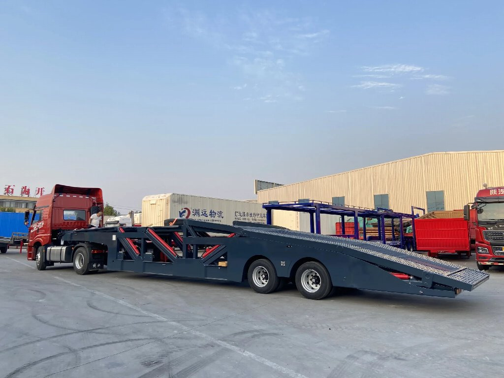

CHENLU car carrier in an unloaded configuration. The site surface, tractor connection and deck positions all form part of the loading path.

A vehicle meets three different contact conditions as it moves along the loading path:
  • Approach angle: whether the front and its overhang clear the ramp foot before the front tyres climb.
  • Breakover angle: whether the underbody between the axles clears a convex transition while the tyres are on opposite sides.
  • Departure angle: whether the rear and its overhang retain clearance as the rear tyres cross a transition.
The following breakover relationship is only an initial screen for an ideal convex transition. It treats the vehicle as a rigid body, places the front and rear tyre contact points on one reference plane, ignores tyre and suspension deflection, and uses one lowest point within the wheelbase.
Let c be the height of that point above the reference plane. Let a and b be the horizontal distances from its projection to the front and rear tyre contact points. The model gives:
β = arctan(c ÷ a) + arctan(c ÷ b)
If the lowest point is approximately at the middle of wheelbase W:
β ≈ 2 × arctan(2c ÷ W)
For a vehicle with a 2.70 m wheelbase and a 0.13 m central low point, the simplified result is about 11.0°. A convex transition near that order of magnitude calls for a closer underbody-clearance check.
The value is a geometric estimate, not a breakover angle approved by the vehicle manufacturer. Tyre and suspension movement, loading condition, uneven ground and unrecorded guards, exhaust parts or body accessories change the real margin. Two vehicles with the same minimum ground clearance may therefore behave differently because their wheelbases, overhangs and low-point positions differ.

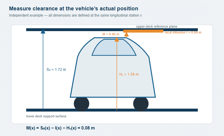

How Should Clearance Between the Upper and Lower Decks Be Measured?
Clearance inside a double-deck car carrier is rarely one constant value. The upper deck may contain inclined and hinged sections. Cross-members, hydraulic equipment or other parts can project into the space below. When a vehicle sits on an inclined deck, the roof’s highest point also moves relative to the upper structure.
To avoid deducting the same obstruction twice, define three quantities at longitudinal position x:
  • S₀(x): the base deck spacing from the lower vehicle-support surface to the upper reference plane, before local projections are deducted.
  • I(x): the distance that a cross-member, cylinder or other structure projects from the upper reference plane into the deck space.
  • Hᵥ(x): the vertical height of the vehicle envelope at that position, measured from the lower support surface with the vehicle at its actual parked angle.
M(x) = S₀(x) − I(x) − Hᵥ(x)
In an independent example, the base spacing is 1.72 m, a local structure projects by 0.06 m and the vehicle envelope at that position is 1.58 m:
M = 1.72 − 0.06 − 1.58 = 0.08 m, or 80 mm.
The 80 mm result is only a static arithmetic margin. The Hyundai GLOVIS manual cited above requires at least 4 in (about 102 mm) between the vehicle roof and the upper deck within its own scope. If that procedure applies, 80 mm does not meet its requirement. Other vehicles and operating systems need their own criteria; 102 mm is not a universal value.
Stated overall vehicle height is useful for screening. Final checks should follow the actual envelope of the roof, mirrors, roof rack, antenna and door frame. Clearance with an empty carrier does not establish clearance after every adjustable deck is placed in its transport position.
The calculation separates base spacing, local structural intrusion and the vehicle envelope so the same obstruction is not deducted twice.

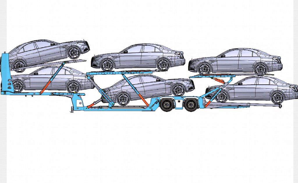

The published CHENLU two-axle double-deck car carrier semi-trailer is 16.12 m long and uses upper platforms with adjustable height and angle, together with rear loading ramps. Its product page shows two examples:
Published CHENLU exampleVehicle mixLoaded height stated on the page
Layout A5 sedans4,000 mm
Layout B3 SUVs + 1 sedan3,921 mm
These rows describe different vehicle mixes. They are not a controlled comparison using the same vehicles with only the deck positions changed. The vehicle counts and loaded heights illustrate layouts published for that model; they do not promise fixed capacity for other sedan or SUV combinations. Actual results depend on vehicle length, height, mass, parked angle and deck position. Loaded-height measurement and tractor connection state should be confirmed from the drawing for the intended configuration.
Loading order belongs in the layout. If one vehicle must cross an adjustable section that another vehicle already occupies, the sequence has to change. Multi-stop unloading also needs checks for the remaining vehicles and deck positions after each removal. A full-load drawing represents one moment, not every intermediate state.
Published CHENLU five-sedan example. A different vehicle mix requires a new layout and load check.

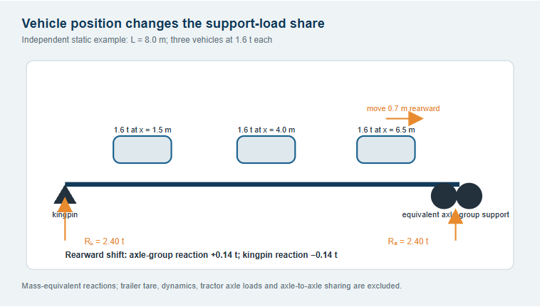

How Does Vehicle Position Affect Car Carrier Trailer Weight Distribution?
A position that is geometrically available may still produce an unsuitable load distribution. A first static comparison can treat the semi-trailer as supported at the kingpin and the equivalent centre of the trailer axle group.
Let L be the distance from the kingpin to the axle group’s equivalent support centre. Vehicle i has mass mᵢ, with its centre of gravity xᵢ behind the kingpin. The mass-equivalent reactions added by the vehicles are:
Trailer axle-group reaction Rₐ = Σ(mᵢ × xᵢ) ÷ L
Kingpin reaction Rₖ = Σmᵢ − Rₐ
Consider an independent case with L = 8.0 m. Three vehicles each have a mass of 1.6 t, with their centres of gravity 1.5, 4.0 and 6.5 m behind the kingpin. Trailer tare mass and other effects are temporarily excluded:
  • The vehicles add a mass-equivalent reaction of 2.40 t at the trailer axle group.
  • They add the same 2.40 t at the kingpin.
  • Moving the last vehicle’s centre of gravity from 6.5 to 7.2 m increases the axle-group reaction by 0.14 t and reduces the kingpin reaction by 0.14 t.
Total vehicle mass remains unchanged; the share carried by the two supports changes. A complete calculation also includes trailer tare mass and its centre of gravity, every other vehicle, dynamic effects, load sharing within the axle group, and the way kingpin load passes through the fifth wheel to the tractor axles. This example explains position and support reactions. It is not a CHENLU axle rating.
The position of a heavier vehicle must therefore satisfy both the geometric envelope and the load-distribution calculation. Car carrier trailer weight, vehicle count and individual vehicle mass are parts of one loading problem rather than independent specifications.
Independent mass-equivalent reactions. Trailer tare, dynamic effects, tractor axle loads and axle-to-axle sharing are excluded.
