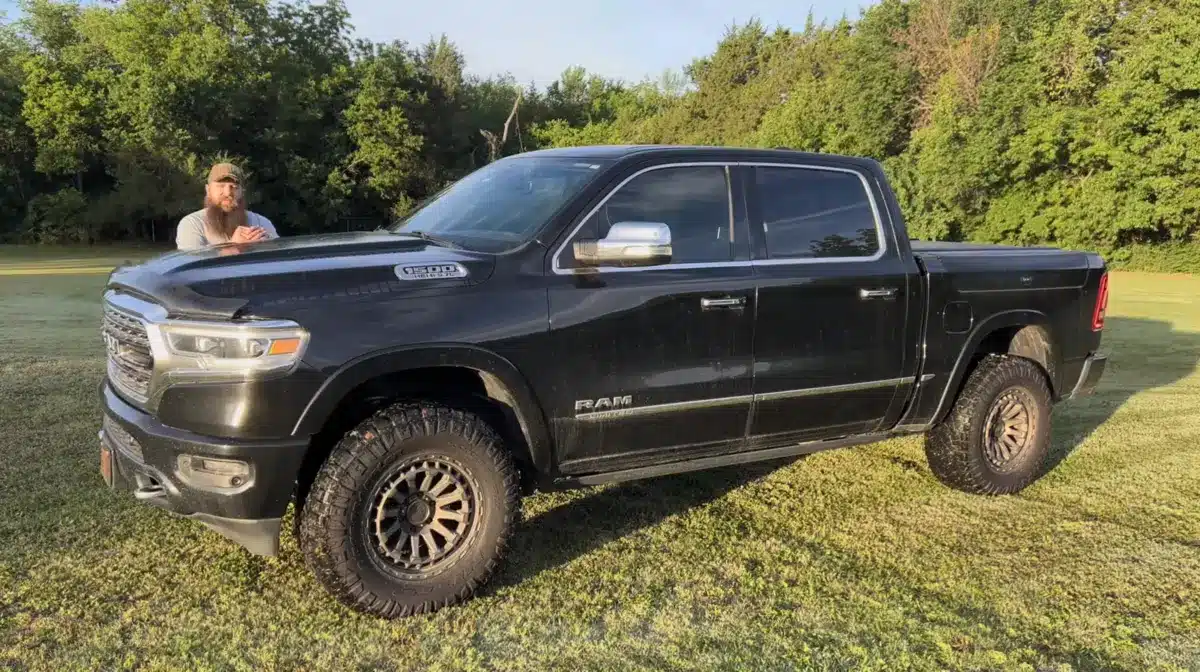

A Ram 1500 owner review usually comes after 10,000, 50,000 or perhaps 100,000 miles. Justin Wheeler has a much longer story to tell. His 2019 Ram 1500 Limited has traveled approximately 323,000 miles and accumulated more than 9,200 engine hours.
The truck did not spend those miles cruising gently between a garage and an office. Wheeler says it was driven nearly every day, used for towing, left outdoors and worked hard. That makes what remained original remarkable. It also makes the major Hemi failure that finally parked the truck worth examining.
Ram 1500 Owner Review Starts with 323,000 Hard Miles

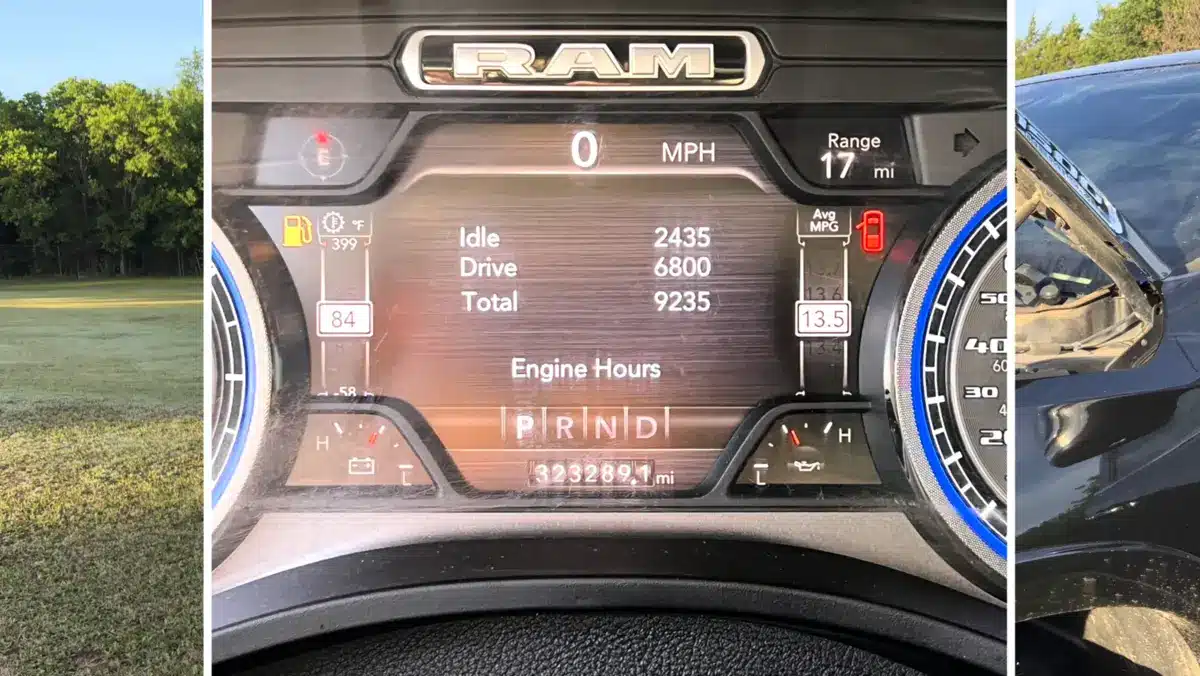

2019 Ram 1500 odometer showing 323,289 miles and 9,235 engine hours
The Ram 1500 recorded 323,289 miles and 9,235 engine hours, including 2,435 idle hours (Screenshot via YouTube/Justin Wheeler)
Wheeler bought the fifth-generation Ram 1500 Limited new in August 2019. Although his video title rounds the mileage to 325,000, the truck had approximately 323,000 miles when he recorded the update.
The computer showed 9,235 engine hours, including 2,435 idle hours. That averages about 35 miles for every engine hour, reflecting a combination of highway travel, towing and substantial time spent idling.

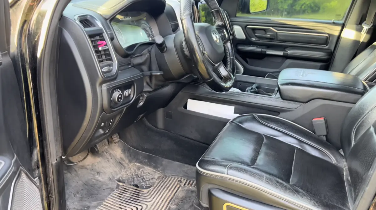

The body and cabin tell the story of a working truck. The grille and painted bumper have rock chips, the driver’s seat shows wear and some of the interior trim has aged. Still, the leather, dashboard controls, power seats, power mirrors, sunroof and power running boards remained functional.
Wheeler also reported no widespread electrical breakdowns during his ownership. Some exterior lights became intermittent, but the truck avoided the cascading electronic failures many owners fear as modern vehicles age.

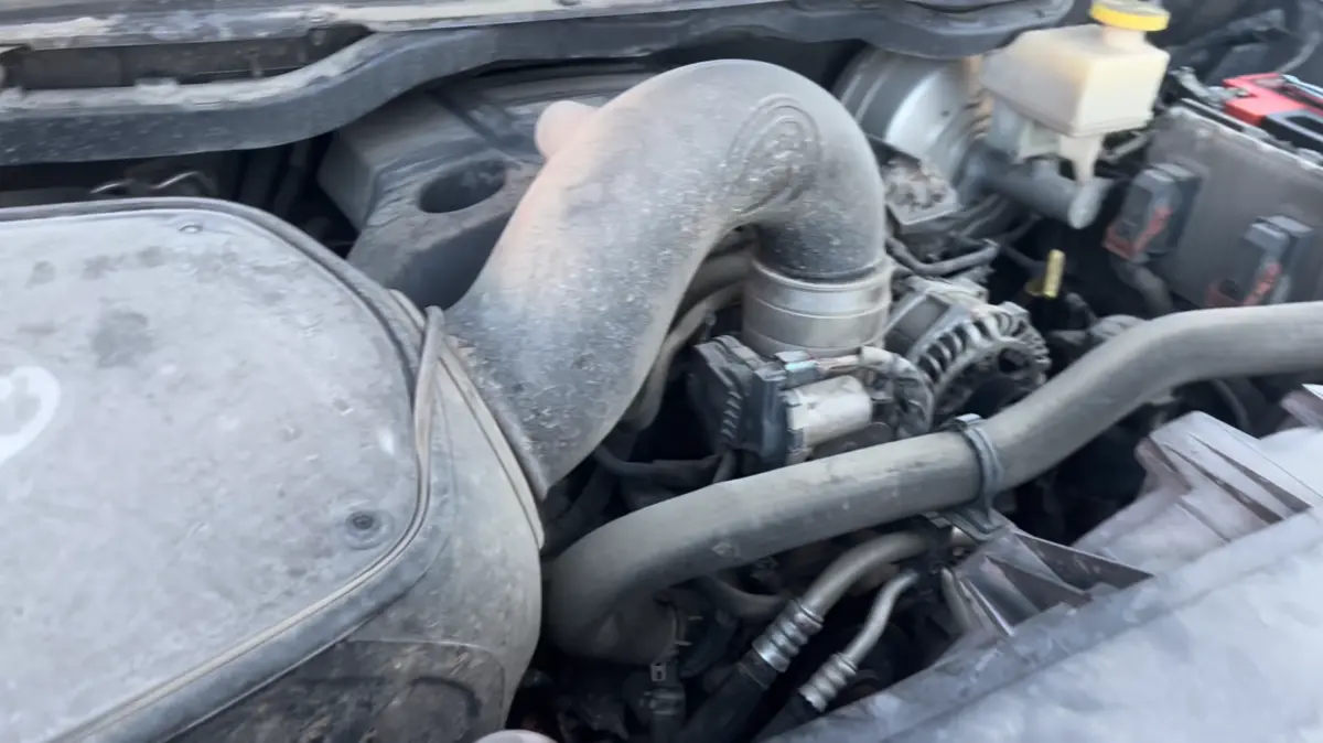

Original 5.7-liter Hemi V8 engine in a 323,000-mile Ram 1500
The original 5.7-liter Hemi V8 and eight-speed automatic transmission remained in the truck after more than 323,000 miles (Screenshot via YouTube/Justin Wheeler)
The most surprising detail may not involve the Hemi at all. Wheeler says the Ram’s eight-speed automatic transmission is original and has never had its fluid changed.
That does not mean owners should treat this truck as a recommended maintenance schedule. It is one unusually high-mileage example, and transmission service decisions should be based on the manufacturer’s schedule, operating conditions and the condition of the fluid. However, reaching more than 323,000 miles on the factory transmission and fluid isn’t unusual these days with sealed transmissions. Still, it gets people’s attention who remember transmission fluid service intervals.
Several other major components remained original as well, including the alternator, water pump, power-steering components and brake master cylinder.
Wheeler says he changed the engine oil and filter every 10,000 miles using Pennzoil Ultra Platinum 5W-20. That interval helped carry the original 5.7-liter Hemi well beyond 300,000 miles. He eventually had a failure; however, it is hard to say more regular oil changes beyond the manufacturer’s recommended 10k, as he followed, would have prevented it.
Our guide to 2019-2026 Ram 1500 engine problems explains that the phrase “Hemi tick” can describe two different conditions. A leaking exhaust manifold can create a tick that fades as the engine warms, while lifter and camshaft wear is a separate and potentially destructive internal-engine problem.

Interior of a 2019 Ram 1500 Limited after more than 323,000 miles
The Ram 1500 Limited’s cabin shows normal wear from more than 323,000 miles, while most powered equipment continued to work (Screenshot via YouTube/Justin Wheeler)

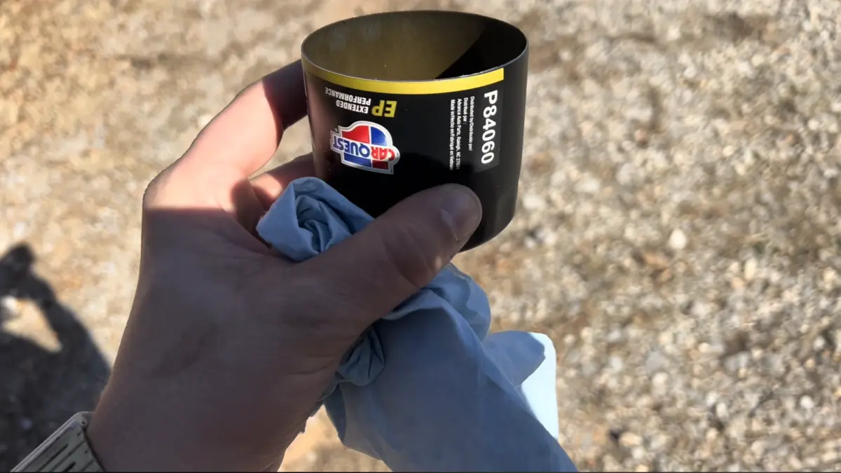

Cut-open oil filter inspected after a Ram 1500 Hemi lifter failure
Metal found during the oil-filter inspection helped confirm serious internal wear after the Hemi developed a loud clacking noise (Screenshot via YouTube/Justin Wheeler)
The failure that finally parked the Ram occurred while Wheeler was in Kentucky, approximately 800 miles from home. He noticed oil pressure dropping to roughly 15 psi at a stop and then heard a pronounced clacking sound from the 5.7-liter Hemi.
The check-engine light was flashing, but Wheeler decided to drive the truck home. It completed the trip, an impressive final demonstration of durability that may also have increased the internal damage.
Once home, he drained the oil and cut open the filter. He found metal contamination in the filter and on the magnetic drain plug. An oil analysis also showed elevated iron.
His diagnosis was a failed hydraulic roller lifter that damaged a camshaft lobe. As the damaged surfaces continued to run against each other, metal circulated through the lubrication system. This was not the relatively harmless exhaust-manifold version of the Hemi tick. It was a major internal-engine failure.

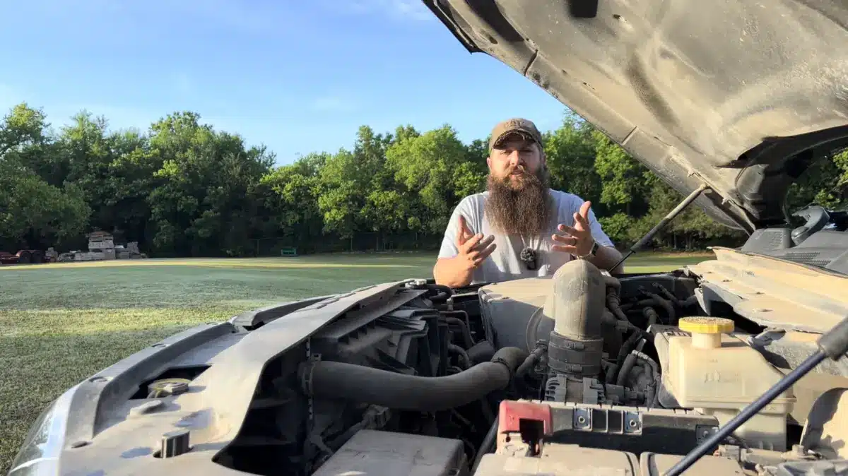

Why the Owner is Not Giving Up on His Ram 1500
Ram 1500 owner standing behind the open hood before repairing the Hemi engine
Wheeler plans to repair the camshaft and lifters rather than give up on his high-mileage Ram 1500 (Screenshot via YouTube/Justin Wheeler)
Wheeler does not present the failed Hemi as proof that the Ram 1500 is disposable. His conclusion is nearly the opposite. The truck worked hard for more than 323,000 miles, retained its original engine and transmission for that entire run and brought him home even after the lifter failure became obvious.
He plans to disassemble the engine, replace the camshaft and lifters and repair any additional damage he finds. A follow-up video already documents the cam-and-lifter work, showing that this is a repair story rather than the end of the truck.
