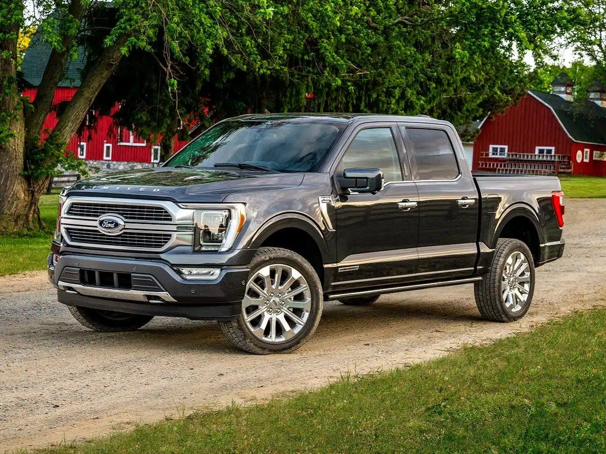

Ford recalls 850k vehicles
This 2022 Ford F-150 is just one of several vehicles being recalled. (Photo courtesy Ford Motor Company)
Ford is recalling 850k vehicles all thanks to Mexico supplier fuel pump mishaps causing vehicles to stall.
