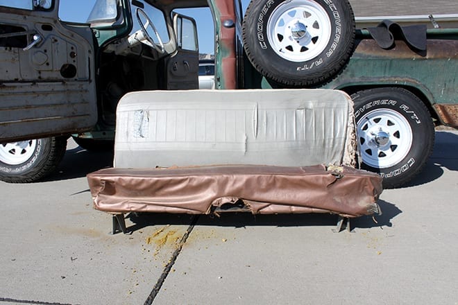

Without question this seat had to go.
If there is one thing that magically makes an interior look a million times better, it is new seats. This is especially the case for Swede who received new seat covers. The ole’ Chevy looks much, MUCH better.
I got the seat covers from LMC Truck for a pretty reasonable rate of $149. I also picked up a $40 seat repair kit and thought I was all set. Well, as I have learned working on older vehicles, repairing one things takes three times as long. After tearing down the seat, I noticed several issues.

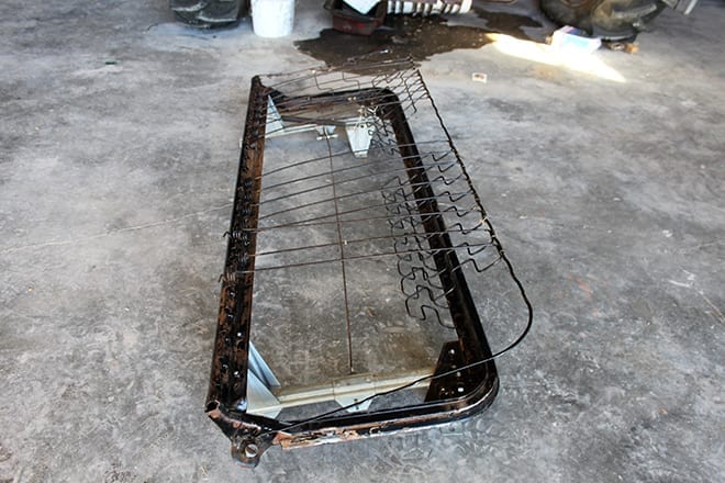

The broken rod along with some broken springs was going to be a problem.
Chief among these issues was the broken rod connecting all the spring on the front of the seat running the length of the seat. This rod is critical to making the seat work and it looked like someone had welded it once upon a time.

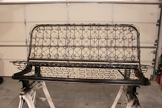

This is also a part that simply isn’t available to purchase through the aftermarket. Fortunately, we had another Chevy seat at the family farm. Taking that seat apart revealed a perfectly good connecting rod as well as a connecting rod on the driver’s side. Looking at both seats, I determined the best course was to mix and match parts to build one good seat. After a morning of messing around with the seats, I was able to do just that.
Project 1962 Chevy C10 Swede Update - New Seats
Taking two seats and making one good one was a pretty simple job of mix and matching the best parts.
Next, I washed and cleaned the new seat. However, this really only revealed a mix match of colors with the original black color having rubbed off. I decided the best course was to paint the seat hardware to give it a much cleaner look and, when I pulled the back of the seat forward, it would simply look better.

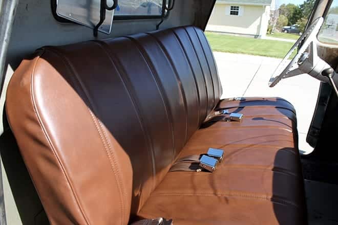

Then, I got the seat into the truck and with some assistance, I installed seat belts I had left over from another project. This seat belts work for now, but I’ll be swapping them out for longer ones in the future.
Now THIS is a seat!
