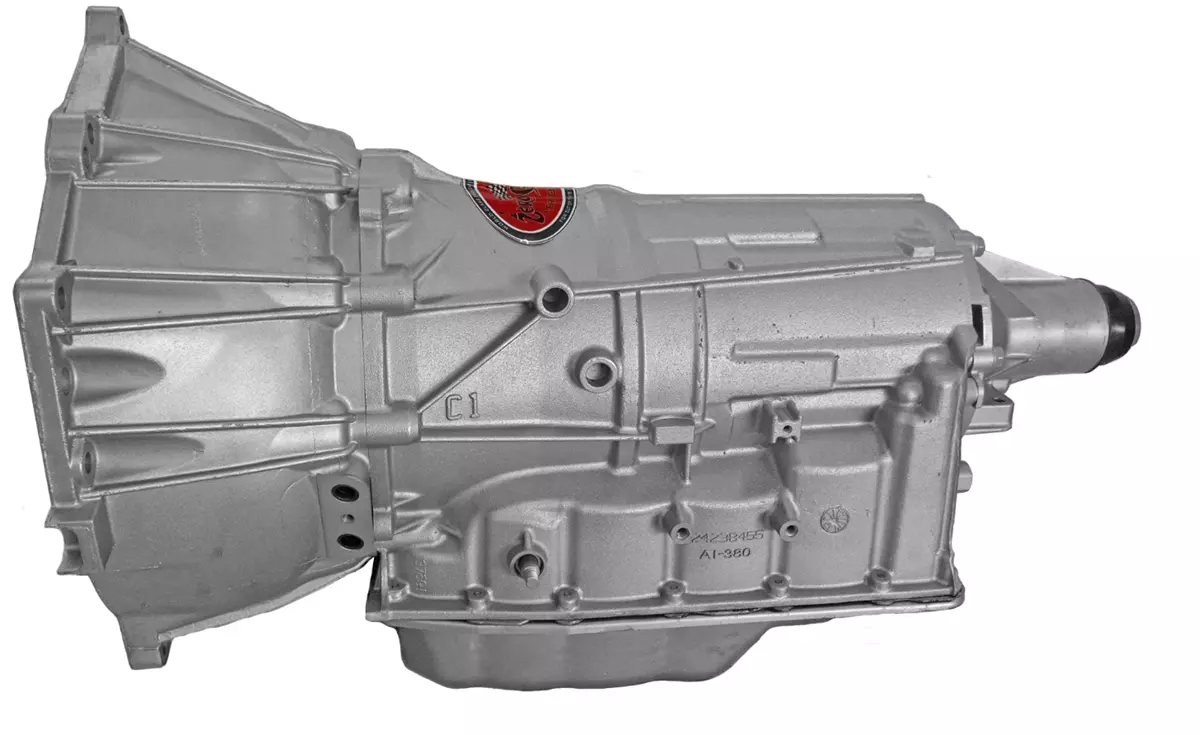

6-Speed MYC 6L80
GM GL80 transmission (Courtesy of General Motors)
Used for the 2019-2021 model  years, the 6L80 transmission was a carryover from the previous generation Silverado. There are no recalls for the 2019+ model years with this transmission. There are, however, several technical service bulletins associated with it.
TSB 22-NA-182 (Updates through 2024): Addresses harsh shifting, shudder, stalling, and overheating. The cause is often a twisted cooler line or a faulty Thermal Bypass Valve (TBV). The fix involves checking the TBV opening temperature (which should be 158°F for the 6-speed) or installing an updated bypass kit.
Other known problems with this transmission include:
  • Overheating, resulting in fluid breakdown, especially when under heavy load.
  • Aluminum valve bodies are known to wear down and create hydraulic pressure leakage in the 6L80, often leading to a stuck TCC regulator valve and slipping shifts.
  • The 3-5-R clutch drum is known to fail due to weld assemblies breaking in 3rd, 5th, and reverse gears.
  • Cracking 1-2-3-4 apply piston cracking under high hydraulic pressure.

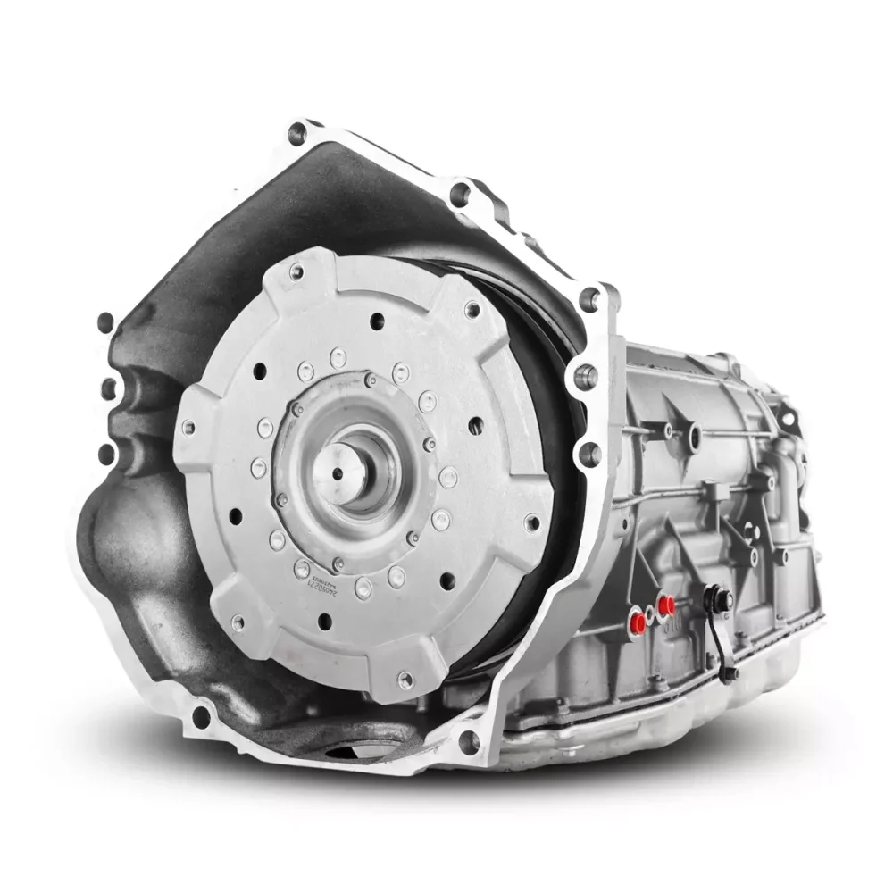

8-Speed 8L80 and 8L90
GM 8L90 transmission (Courtesy of General Motors)
The 8L80 transmission was introduced to the Silverado in 2024 as a truck-specific version of the 8-speed. The 8L90 has been used in a variety of high-torque applications throughout GM’s lineup, including the Corvette and Camaro. Both continue to be used into 2026, though the 8L80 replaced the 8L90 in many of the Silverado’s configurations.
Neither of these transmissions have been the subject of a federal recall. There are, however, some technical service bulletins associated with them.
TSB 18-NA-355, TSB 20-NA-142, and variants: Torque converter shudder on 2015-2025 models with the 8L80 and 8L90. TSB dictates a transmission flush with a specific fluid to resolve moisture absorption issues.
N212328090: A limited internal “Customer Satisfaction Program” which explicitly targeted a catastrophic manufacturing defect in the 8L80 and 8L90 transmission reaction carrier. Less than 100  units were affected.
Other known problems for the 8L80 and 8L90 transmissions:
  • Harsh, delayed, or erratic shifting caused by faulty solenoids or valve body wear creating pressure leaks.
  • 2-3-4-6-8 drum failure caused by wear in the pressure regulator or boost valve circuit.
  • Pump Stator can shift out of place or turn off-center, blocking cooler oil return lines and causing overheating.
  • Overheating under load causing premature fluid breakdown.
The Speerly v. General Motors lawsuit concerns alleged defects in 8L45 and 8L90 eight-speed transmissions in certain 2015–2019 GM vehicles. On June 27, 2025, the Sixth Circuit vacated the class-certification order; that ruling was not a finding that the transmissions were defect-free.

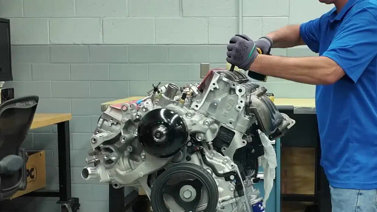

Close-up of a technician’s gloved hands using a torque tool on a GM development engine.
Close-up of the torque tool and engine during GM’s development build demonstration. Video still: Tim Esterdahl / Pickup Truck + SUV Talk.
