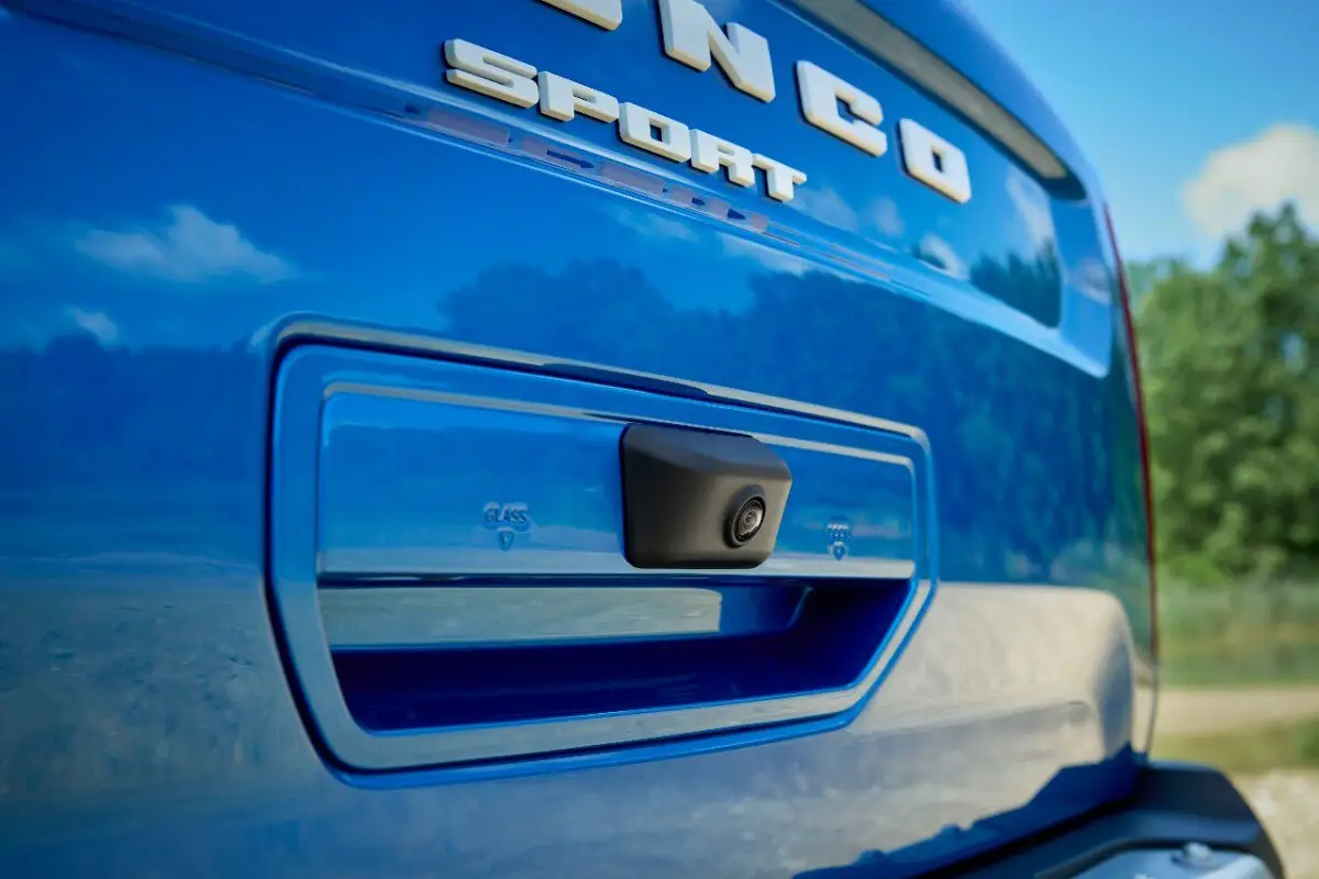

For some reason Ford had a run of bad luck with backup cameras the last few years. In this case 2021-2024 Bronco Sport models and a whole bunch of other Ford models fell under NHTSA recall 25V-442 regarding instances where the backup camera doesn’t work as intended. It turns out an issue in the SYNC software can make the infotainment screen go blank, turn black, or just continue showing the backup camera view. Like most modern technology problems the fix is a software update.
