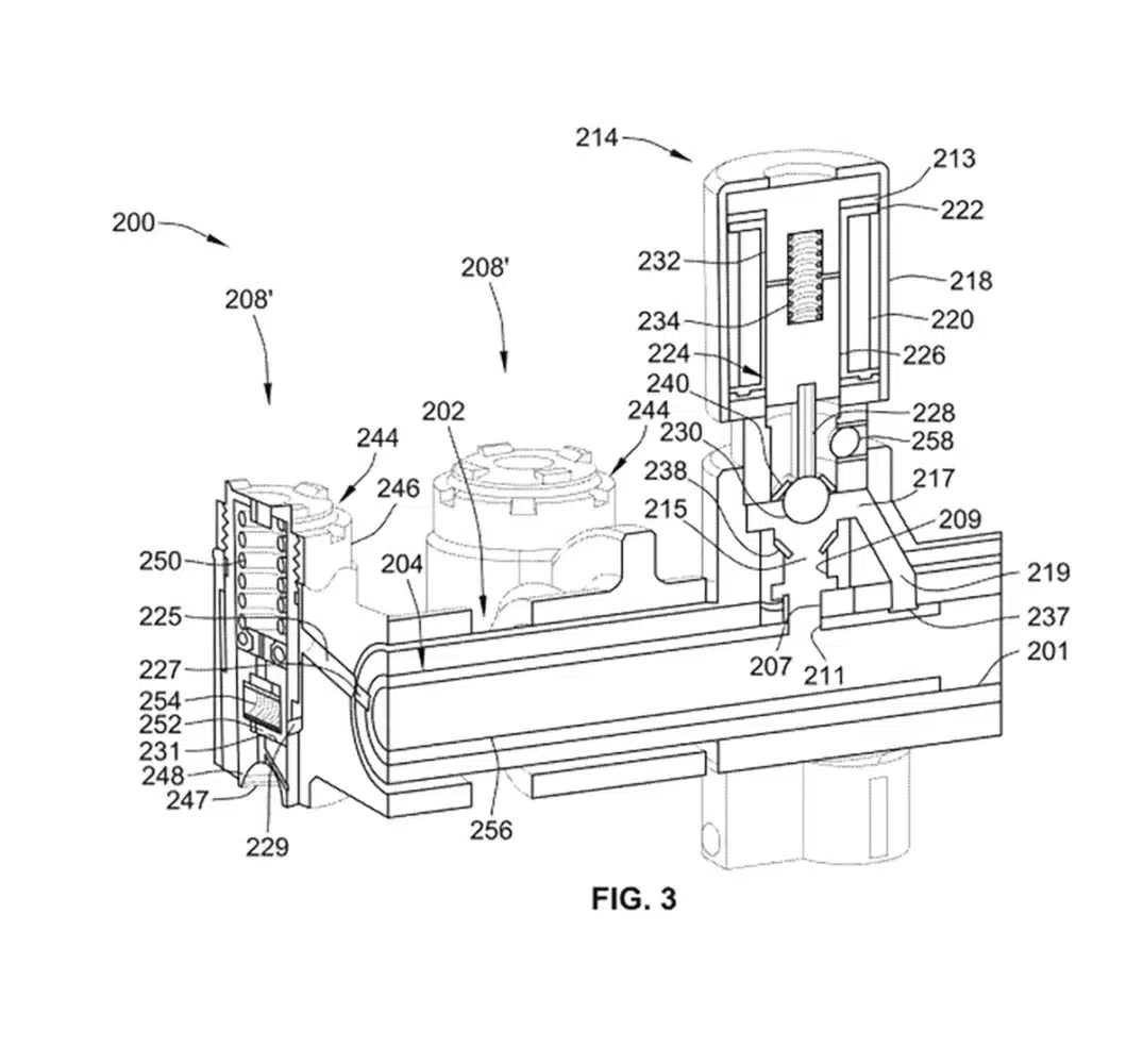

What Makes This System Unique
New GM Cylinder Deactivation System 2
This system uses a rocker shaft (202) and an oil control valve (214) to better control oil flow when turning on and off the cylinders. (Screenshot by Tim Esterdahl)
TLDR; the new system uses a rocker shaft and an oil control valve to turn off the intake and exhaust ports effectively turning off cylinders.
Presented are variable displacement valvetrain (VDV) systems with rocker shaft fluid porting and insert sleeves for engine cylinder deactivation, methods for making and methods for using such VDV systems, and motor vehicles with such VDV systems. In a non-limiting example, valvetrain control systems and methods are presented for engine cylinder deactivation using pressurized switching-oil routing within the rocker shaft in combination with pushrod disengagement at the rocker-rod interface (as opposed to the pushrod-valve lifter interface).
The valvetrain control system’s oil flow gallery routes oil from a feed passage in the cylinder head, into and through the rocker shaft and an insert sleeve within the rocker shaft, to an oil control valve (OCV) that is mounted onto a manifold that circumscribes the rocker shaft. The OCV is selectively activated to transmit oil to a worm track that is recessed into the exterior of the insert sleeve; the worm track feeds oil through a delivery port in the rocker shaft to a spring lock deactivation (DEAC) unit that is integrated into a pushrod mating end of the rocker arm.
Pressurizing the spring lock deactivation unit operatively disengages the rocker arm from the pushrod and thereby prevents the transmission of motion/load from the pushrod to the rocker arm; doing so deactivates the rocker arm and an intake/exhaust valve mated with that rocker.
To regulate the flow of oil through the rocker shaft, an outer-diameter (OD) surface of the insert sleeve may sit flush against and seal to an inner-diameter (ID) surface of the rocker shaft.
Switching oil may pass from the pressurized oil bore in the rocker shaft through open longitudinal ends of the insert sleeve; an oil feed port in the circumferential wall of the insert sleeve directs oil into an inlet port of the OCV. When activated, the OCV transmits oil flow from the OCV inlet port to an OCV control port; this control port redirects oil flow, e.g., via a control port passage in the OCV manifold, through a sleeve track pocket to a worm track in the sleeve.
The worm track delivers oil flow through an inlet channel in the rocker arm to the spring lock unit. The OCV includes a pressure-regulating port and a floating check valve that allows a minimum “priming” pressure to be maintained in the control gallery. This priming pressure is sufficient to enable fast switching of the VDV system, but low enough to ensure the VDV system does not inadvertently deactivate the rocker arms when it is not required.

Example of how it will work
New GM Cylinder Deactivation System 3
This illustration shows the oil-ported rocker shaft (202) and a rocker shaft insert sleeve (204). As shown, the rocker shaft will be mounted onto a top face of the engine cylinder head (206) and pivotably supports a series of valvetrain rocker arms (208). For lubrication, the rocker shaft has a pressurized internal bore (201) that receives hydraulic fluid from a fluid sump pump and routes the fluids to the rocker arms. (Screenshot by Tim Esterdahl)
TLDR; the rocker shaft will use hydraulic fluid to operate a spring that will cause it to open and close. When it operates, the rocker arms will move and operate pushrods to open and close intake and exhaust ports.
In an example, there is presented a valvetrain control system for an engine assembly, which has multiple cylinders, intake and exhaust valves for opening and closing intake and exhaust port to each cylinder, a camshaft rotatably attached proximate the valves, and multiple pushrods (e.g., with pushrod lifters) each seated on a respective cam of the camshaft. The valvetrain control system includes a rocker shaft that attaches to the engine assembly and includes an internal shaft bore for receiving hydraulic fluid. An oil control valve unit attaches to the rocker shaft and fluidly couples to the internal shaft bore to receive there from a portion of the hydraulic fluid. Multiple rocker arms pivotably mount onto the rocker shaft; one end of each rocker arm mates with a respective pushrod while the opposite end of the rocker arm mates with a respective valve. A subset of the rocker arms each includes a hydraulically actuated spring lock unit that is mounted to, integrally formed with, or otherwise attached to the pushrod end of the rocker arm. Each spring lock unit attaches its rocker arm to the pushrod and fluidly couples to the OCV unit. Receipt of hydraulic fluid from the OCV unit causes the spring lock unit to drivingly disengage the rocker arm from the pushrod. An insert sleeve is mounted inside the rocker shaft’s internal bore to receive hydraulic fluid from the rocker shaft. The insert sleeve includes a feed port that transmits hydraulic fluid from the rocker shaft and insert sleeve to an OCV inlet port of the OCV unit, and a feed pocket that transmits hydraulic fluid from an OCV outlet port of the OCV unit to each spring lock unit.
