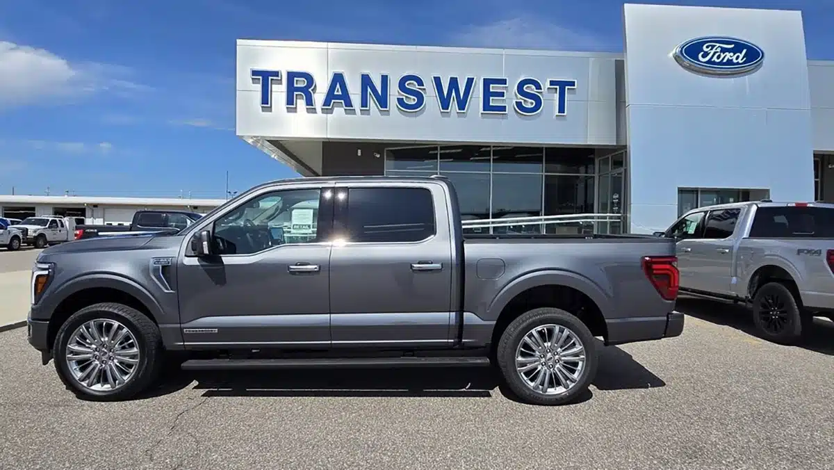

Other luxury trucks have payload concerns?
2026 Ram 1500 Payload Explained 6
Other luxury trucks like this Ford F-150 Platinum have higher payload numbers, but this is due to less options and a higher GVWR. (Photo courtesy Transwest Ford)
I did some research and found door jamb stickers for other luxury trucks on sale on dealership lots across the country or models I’ve had in my driveway for a week-long review.
Here are the results:
2025 Ford F-150 Platinum with 3.5-liter V6 Powerboost full hybrid
1,269 pounds payload – 7,400 pounds GVWR
2025 GMC Sierra AT4X AEV with 3.0-liter inline 6 Duramax diesel
1,048 pounds payload – 7,300 pounds GVWR
2026 Ram 1500 Tungsten with 3.0-liter inline 6 high output Hurricane
1,035 pounds payload – 7,100 pounds GVWR
2022 Ram 1500 Limited with 5.7-liter V8
1,445 pounds payload – 6,900 GVWR

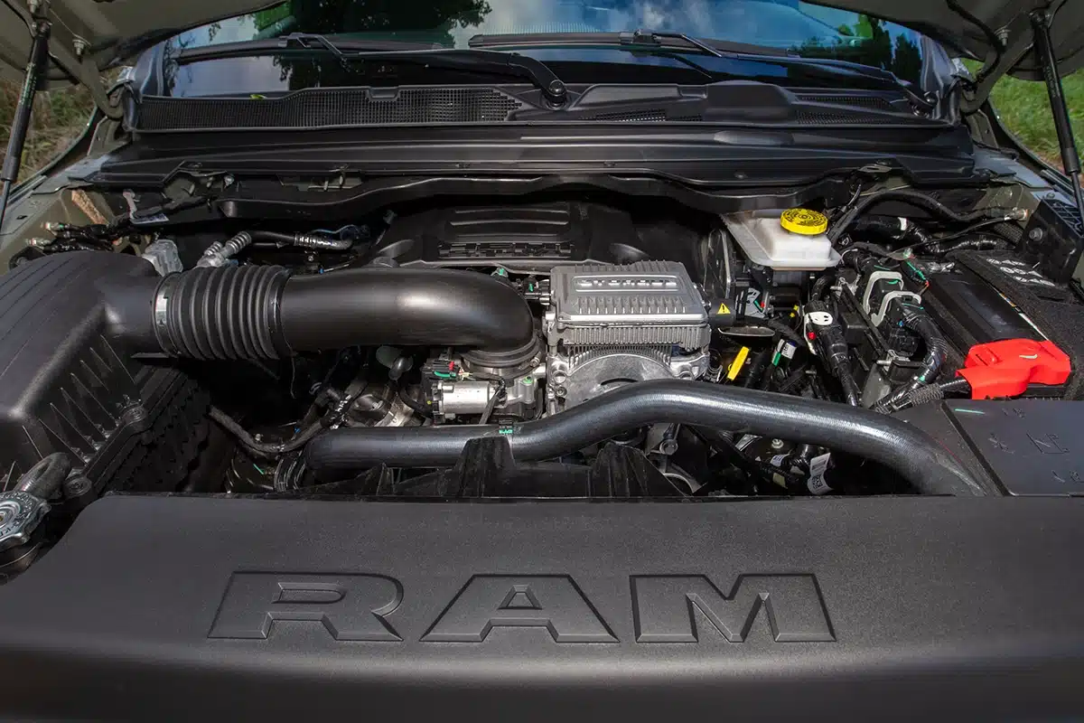

What about the Hemi vs Hurricane weight difference?
2026 Ram 1500 Payload Explained 10
Could it simply be the case the Hemi weighs more than the Hurricane? (Photo courtesy Ram trucks)
Finally, the return of the 5.7-liter Hemi V8 has a lot of excitement for truck fans, but is it causing some issues for payload?
Looking at the Ram towing chart, there is a difference between the 3.0-liter inline 6 twin-turbocharged Hurricane models and the Hemi V8 models.
Payload drops down from 1840 for Hurricane vs 1630 for Hemi models. GVWR is 7,100 lbs for both and the maximum towing capacity is 11,200 for the Hurricane and 9,590 for the Hemi both with the 3.92 rear axle ratio. For the Gross Combined Weight Ratio (GCWR) the difference is greater for the Hurricane with 17,000 pounds vs 15,850 pounds for the Hemi.
Ram lists the weight differences as follows between the Hurricane and Hemi:
TotalFrontRear
Hurricane5,2613,1002,161
Hemi5,4653,2112,254
The Limited Hurricane equipped truck GVWR is 7,100 lbs. If we surmise this number is the same with the Hemi equipped truck, like it is in the Tradesman trim, then the 1,450 payload number puts the curb weight at 5,650 lbs.
This means the 897 payload truck with the Hemi has a 6,203 pound curb weight and is a really heavy truck.

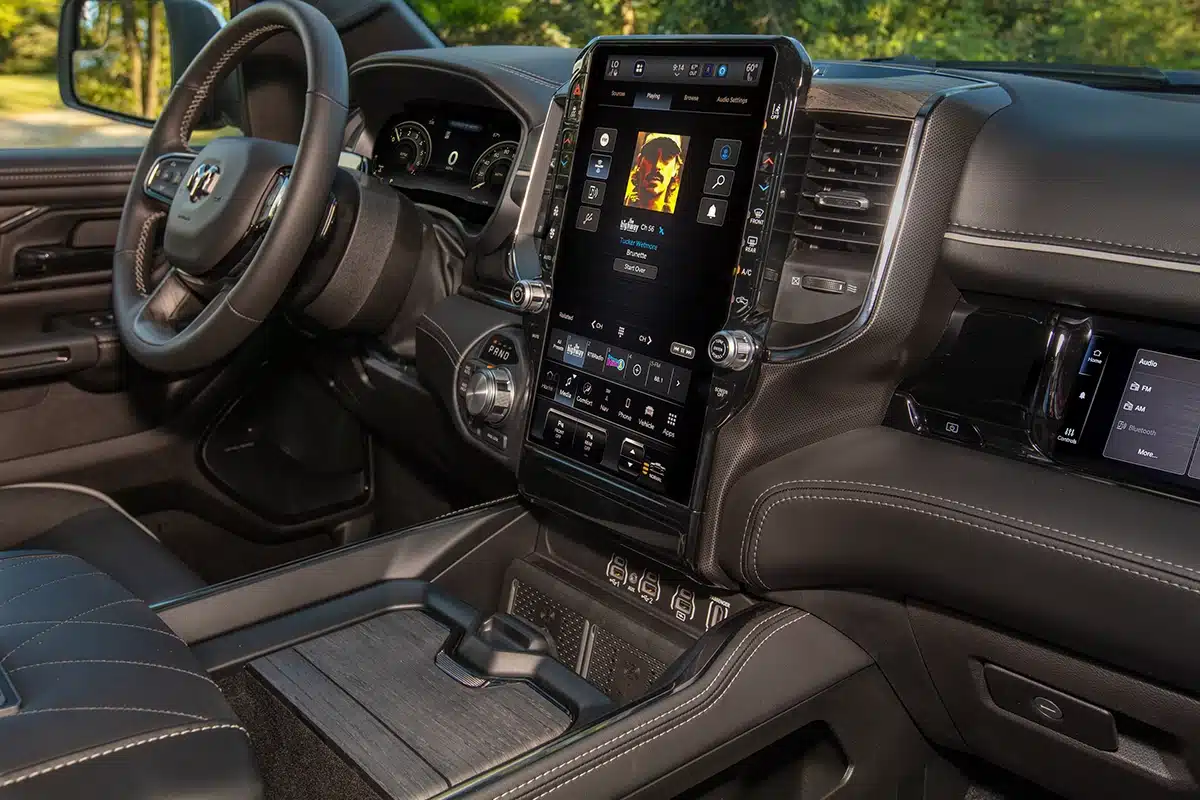

Are the new Ram 1500 electronics to blame?
2026 Ram 1500 Payload Explained 11
Is the big screen, the more digital display and all the new tech with its associated copper wiring to blame? (Photo courtesy Ram trucks)
Interestingly, I looked back at old videos and I reviewed a 2022 Ram 1500 Limited with the 5.7-liter V8 Hemi and it’s payload was 1,445 pounds with options. The difference between that truck and the 2026 model? The new “Atlantis” electrical architecture Stellantis is putting in all their vehicles with new computer modules and wiring.
This was the big hold-up with bringing back the Hemi.
In our video interview with one of the Ram engineering team members, he spoke about how they had to ship trucks to New Zealand, rent out a facility and conduct winter time testing to calibrate 13 different modules to work with the new electrical system and the engine.
Why New Zealand? It was winter there and spring in Michigan. They needed to finish up the winter testing in just a few short months to get the Hemi engines in trucks to market. The team got the go ahead to bring the engine back the week before Christmas and spent January through June-July getting it ready. This quick timeline is impressive and it’s likely also pretty impressive how many millions of dollars they spent making this happen.
It is also plausible adding in the additional computer modules, the copper wiring and more electronics didn’t reduce the weight of the truck. Did it add hundreds of pounds of weight? No, but every pound matters when you are pushing your truck to its limit and adding more options, electronics and hardware doesn’t help get create more payload.
While this truck was certainly an odd-ball build, lower payload on full-size trucks has been a trend we have been seeing for the last dozen years or so and with trucks increasingly becoming rolling computers filled with luxury cabins, it is sure to continue. That’s certainly not going to appease the crowd who wants a basic, work truck with 2,000+ pounds of payload and a sub $30,000 price point.
