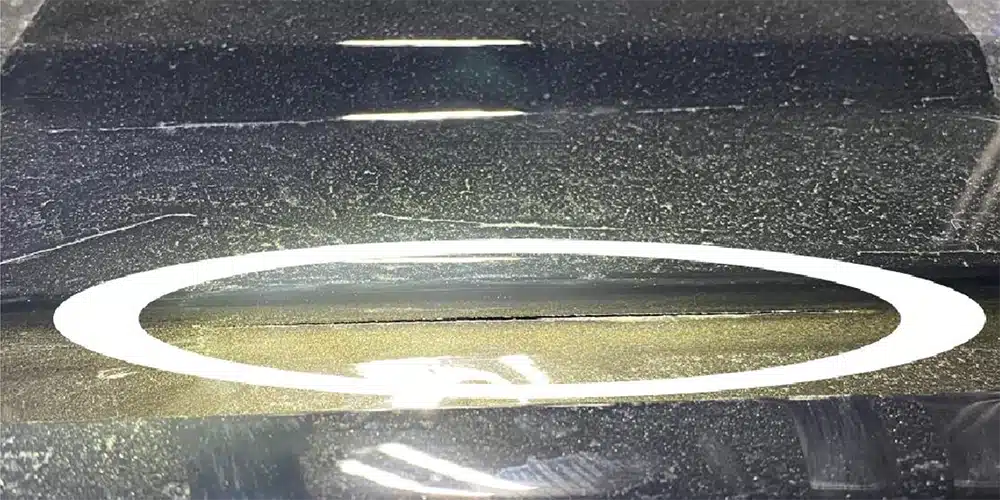

Essentially GM has noted there are certain trucks that may have a split roof panel on the passenger side. According to a manufacturer communication, dealers are supposed to inspect the panel and MIG weld the split if necessary.
The manufacturer communication was issued on November 20, 2023, and it states that 3,067 vehicles are affected. According to the communication, the “stop delivery” was first issued on October 19. It also states after the inspection and repair, the vehicle could then be delivered to the customer.

The manufacturer communication on the NHTSA website shows this image of what the split side panel looks like.
How involved are the repairs?
The repair procedure calls for the dealers to remove the passenger side roof panel joint finish molding and look for any cracks. If no crack is observed, no further action is needed. But the repair itself will involve removing and replacing the side airbag, repairing any water intrusion, welding the split and repainting the entire outer roof panel.
