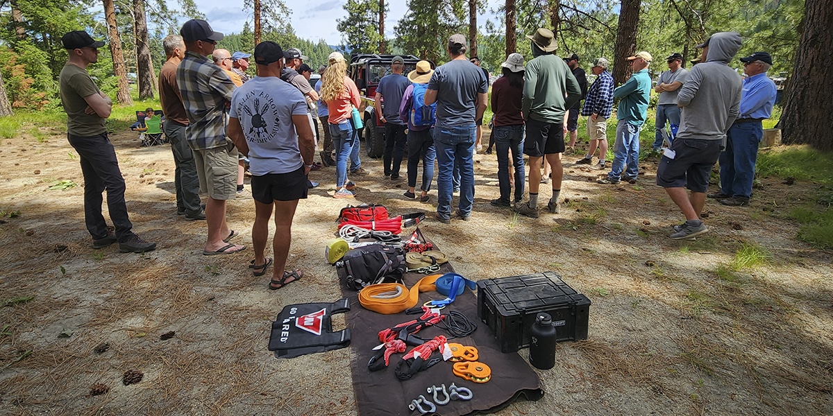

Most basic kits include two shackles, a winch snatch block and various recovery straps (like a static tree trunk protector and kinetic recovery strap). Reputable companies like Warn Industries, ARB USA, and Factor 55 sell premium products and offer a variety of recovery accessory kits to choose from.

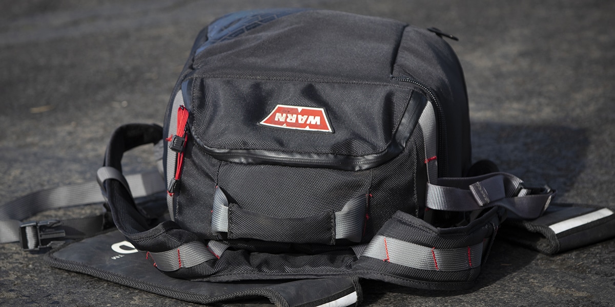

No matter if you buy a robust recovery kit or buy individual pieces and stow them in a heavy-duty bag, don’t forget to take them along with you when you leave for an adventurous day on the trails.
