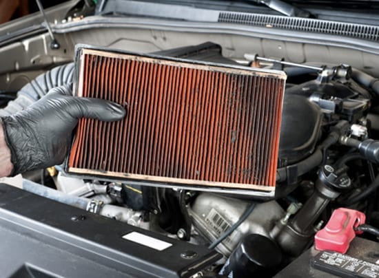

Air Filter: One of the most common tasks drivers tend to do themselves is replacing dirty air filters. You’ll need to replace your air filter every year or every 12,000 miles. A mechanic will likely charge you over a $100 for this simple task, but it only takes around 10 minutes or less.
Just open the hood and look for the air filter, which is typically housed in a rectangular plastic box. Pull out the air filter; you’ll know right away if it needs to be replaced. These things can get black and filthy pretty fast. Throw away the old filter and slide in a new one, which only costs about $10 or $15. Make sure the new filter is in the same position as the old filter.
