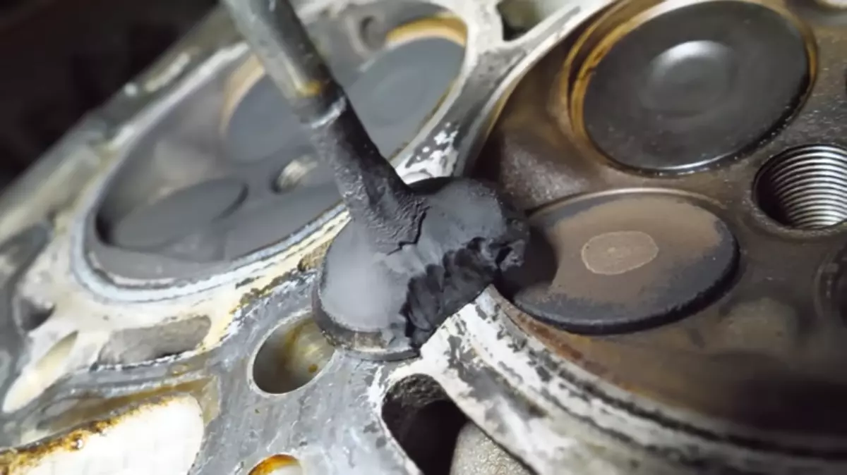

The First Problem: Valves Melting
another bad 2.7 ecoboost 2018 f150 twin turbo v6 dead @ 131k miles 44 47 screenshot image 2
A screenshot from I Do Cars on YouTube shows a melted exhaust valve (Image via YouTube/I Do Cars)

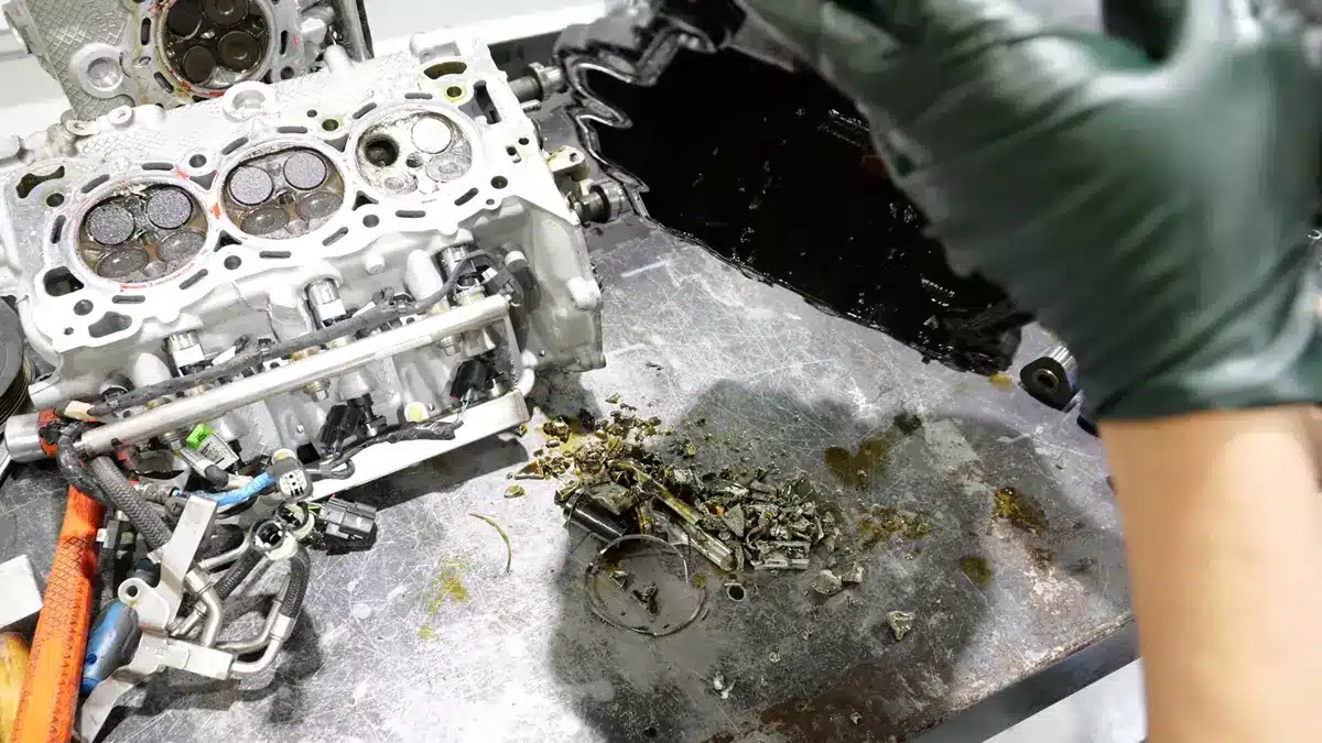

Early in its production life, the 2.7 Nano had a recall for intake valves being brittle and requiring replacement. Each of the engines being torn down was beyond that recall, having either had the work done to fix it or being made after the problem was remedied at the factory. Yet they also had valve failures. Just not on the intake side.
Two of the three engines being torn down had very clear exhaust valve melting that ultimately doomed them. The third had signs that this problem was coming.
The reason for the melting isn’t easy to diagnose. Most likely it is from bad fuel, too much fuel, a failing fuel pump, or bad valve rings or ring seats. Probably a combination of these things.
The 2nd-generation 2.7L EcoBoost uses both port and direct injection. This means that it sprays fuel onto the back sides of the intake valves as well as directly into the combustion chamber. This has advantages, such as keeping the intake valves clear of carbon buildup during low-RPM and high-torque operation, but this feature could also be leading to over-fuel in the combustion process.
A rich fuel mixture could mean that unburnt fuel is being ejected with the exhaust and potentially coating or detonating on the exhaust valves. It could also cause over-pressure in the chamber or late detonation (knock) that would exploit weak points such as valve rings or the valves themselves. Since the exhaust valves would be the valves opening nearest these events, they’d be most susceptible to damage.
The causes here are all speculative, but further analysis of 2.7L EcoBoost engines whose exhaust valves have melted as shown in this I Do Cars’ series of videos could find the culprit(s).

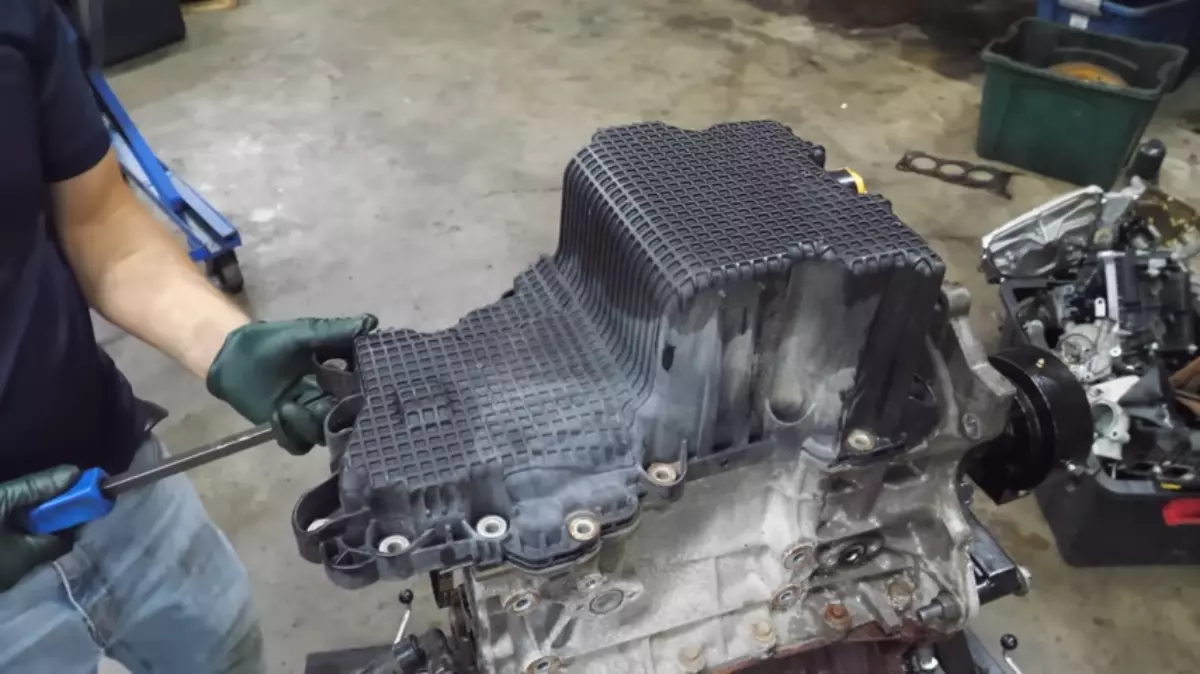

The Second Failure Point: Plastic Pan Means Too Much Gasket Goop
2018 ford f150 2.7l ecoboost teardown. engine failure at 96k miles! 36 5 screenshot image 3
A screenshot from I Do Cars on YouTube shows the plastic oil pan (Image via YouTube/I Do Cars)
For owners of Ford’s trucks and SUVs, the 2.7L EcoBoost has a design problem. It utilizes a plastic oil pan. All by itself, this probably isn’t a big issue. But the gasket seal used to keep it in place might be.
Copious amounts of the silicon and other materials that commonly make up gaskets in engines is often an eventual cause of oil starvation in the engine. The extra material that squeezes into the pan when its bolts are torqued down can eventually get into the oil itself. Once there, it can circulate and clog oil ports. Especially the smaller ones such as those towards the top of the block. This can cause bearing failures,  overheating, or worse.
This overabundance of gasket seal was seen in all three engine teardowns by I Do Cars when the oil pan was removed from the 2.7L EcoBoost.

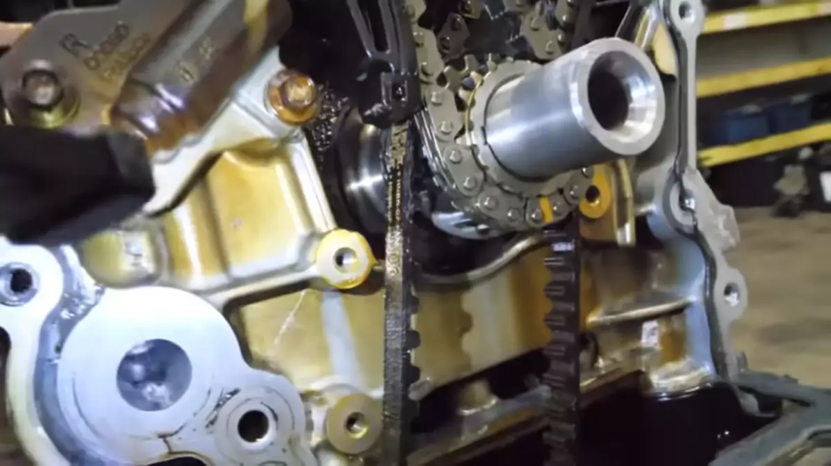

Even the oft-maligned, but so far extremely durable kevlar oil pump belt isn’t a weak point in this 2.7L engine. At least not until its maintenance interval comes around.

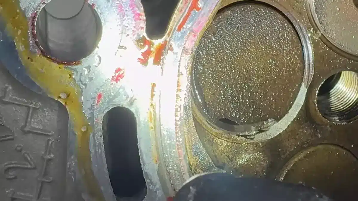

i'd be pissed off! 2022 ford f 150 2.7l ecoboost v6 engine destroyed @110k with perfect maintenance! 22 14 screenshot image 5
A screenshot from I Do Cars on YouTube shows another broken exhaust valve (Image via YouTube/I Do Cars)
The biggest takeaway is that an exhaust valve failure point in the second-generation 2.7L Nano might be more common than expected. Because failures like this can happen and not immediately cause engine breakdown, it may be seen as a symptom rather than root cause of a decommissioned engine. Or maybe never noticed to start with as most warrantied engines are turned in for core value and subsequently crushed.
We can also see, first hand, that while the maintenance interval cost of replacing the oil pump belt is expensive, the belt itself doesn’t seem to be a problem component in the 2.7L EcoBoost. This should help put to rest the complaints many enthusiasts have about this engine.
