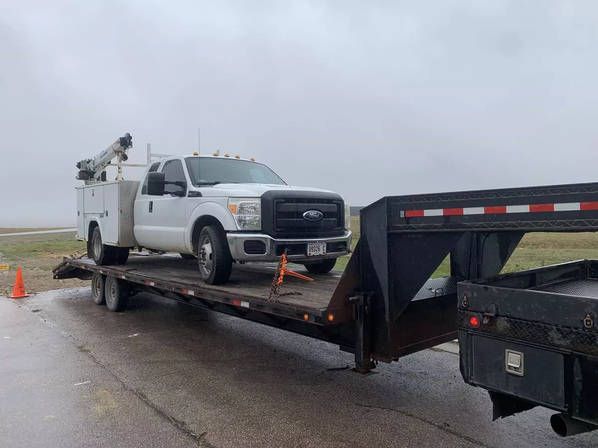

2011 2012 ford super duty being towed
2011-12 ford super duty being towed. (Photo courtesy of Josh Hendrickson)

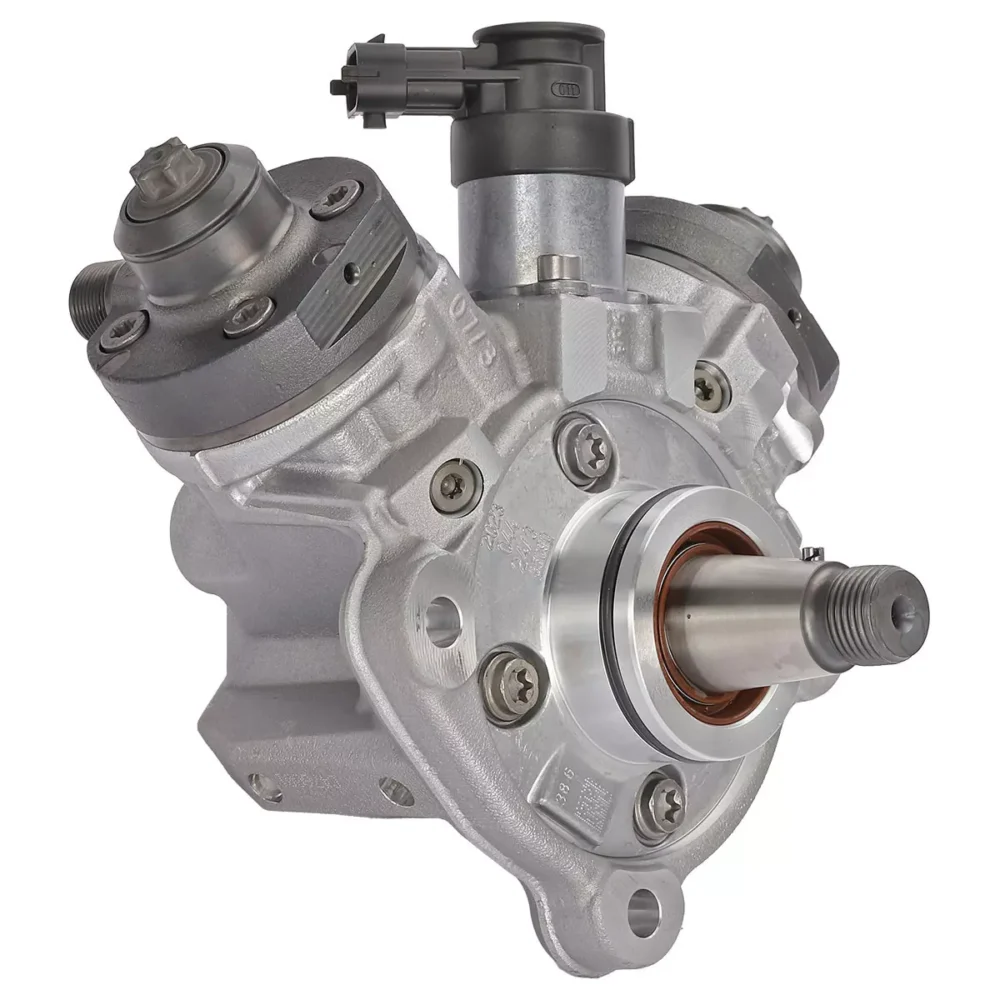

b4bc39df 9d7c 4378 a438 6fd24b521179 87804
Bosch CP4 injection pump for Power Stroke 6.7L engine. (Photo courtesy of Bosch)
The first generation of the 6.7 engines had some severe growing pains, but still presented far less problems than the preceding Power Stroke engines had. Most of these problems were not immediately catastrophic to the engine with the exception of the injection pump. This issue affects every Power Stroke engine to present.
The most critical potential flaw in the 6.7L Power Stroke is the Bosch CP4.2 injection pump. This pump is also used in other diesel trucks such as the LML Duramax, some 6.7L Cummins engines, and the 5.0L V8 in the Titan XD.
The CP4.2 pump is popular due to its lightweight aluminum construction and lower production cost compared to the CP3 pump. While the CP4.2’s failure rate is relatively low, the consequences are severe enough that many owners consider it the engine’s single greatest reliability concern. Unlike the older CP3 pump, the CP4 has less internal lubrication margin and is more sensitive to contaminated fuel and lubrication quality. If the pump fails, it can send metal fragments through the fuel lines, rails, and injectors, causing extensive damage.
Detecting impending failure is nearly impossible, and by the time symptoms appear, the pump and other fuel system components often already require replacement. Proper maintenance, including using high-quality fuel and timely fuel filter changes, is the best way to mitigate this issue.

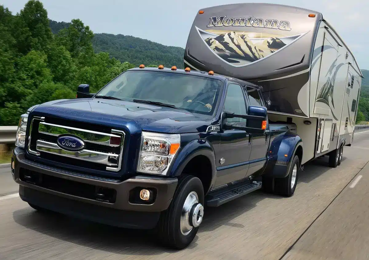

2011 ford f 350 super duty
2011 Ford F-350 Super Duty. (Photo courtesy of Ford)
These early versions of the 6.7L Power Stroke presented the most issues of all 6.7s in the series.
Turbocharger Problems
The 2011 to 2014 models used the Garrett GT32 SST turbocharger, which is essentially two turbos in one, using two compressor wheels and one turbine wheel. This design requires the turbo to spin at very high speeds (over 100,000 rpm stock, and up to 150,000 rpm when tuned) to achieve the necessary boost.
Due to these high speeds, the turbocharger is prone to failure, especially because of the dual ceramic ball bearing center section used initially. Ford addressed some issues by switching to steel bearings in 2013.
The high shaft speeds also meant these early models lacked exhaust braking to protect the turbo.
In 2015, Ford switched to the Garrett GT37 turbocharger for the second generation. This turbo has larger compressor wheels, flows more air, spins slower, and provides more power. It uses a journal bearing center section, which is cheaper to rebuild.
Early models (2011-2012) also had a common coolant leak issue at the turbo coolant inlet pipe, which Ford quickly fixed.
Exhaust Gas Temperature (EGT) Sensor Failures
Certain 2011-2012 F-350, F-450, and F-550 trucks with the ambulance package experienced faulty EGT sensors. These sensors are part of the emissions after-treatment system. A failed sensor could cause the vehicle to shut down while driving and fail to restart, leaving emergency vehicles stranded.
Outside of ambulance packages, EGT sensors are generally known to be problematic but are inexpensive (around $35-$50) and easy to replace, usually taking under 20 minutes. Ford did not issue any TSBs or recalls for them.
Other Common Issues
  • Nitrogen Oxide (NOx) sensors are known to fail frequently on 2011-2012 trucks.
  • Early models had defective radiators from the factory.
  • Some early production engines experienced glow plug drop issues, which can cause catastrophic failure. This problem is mostly limited to early chassis cab models and has not led to recalls.
