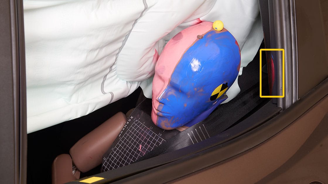

During rebound, the rear passenger dummy’s head moved outside of the side curtain airbag on the Jeep Renegade and hit the C-pillar hard. The head protection is inadequate and puts the head at risk of possible contact with outside objects. (Image courtesy of IIHS)

The test shows instances of heads slipping between the side-curtain airbag and the window following the initial impact, and there were multiple instances of the lap belt slipping from the pelvis to abdomen.
